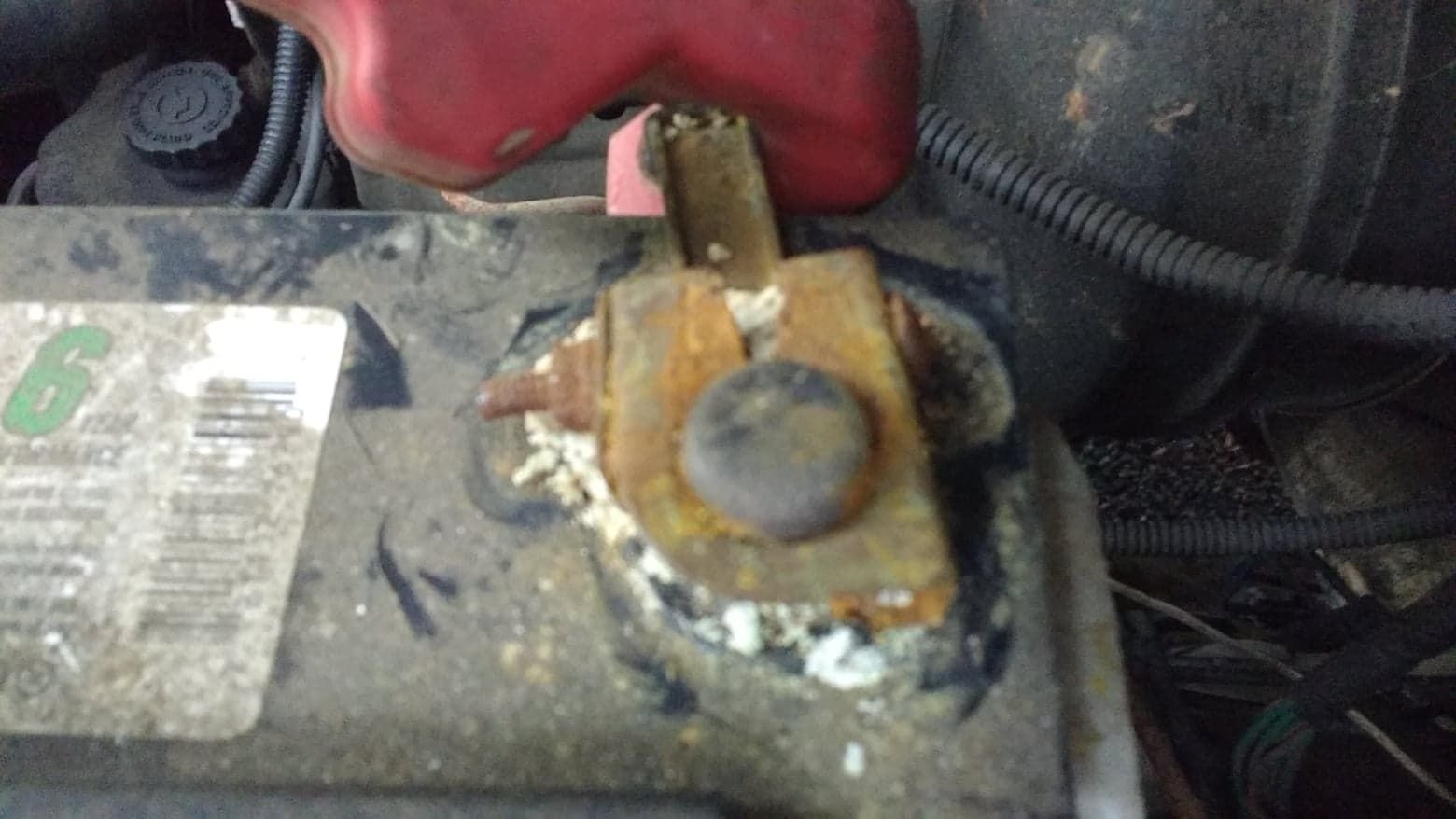

Neg not bad but corrosion on cable
neg not bad
Nasty plus nut is cracked .. need to replace for sure

Posts: 87,479
I don't think the trickle charger would handle fairly dead batteries very well. I know my 'smart' chargers simply shut off if the battery is too low for them to charge...... If that's what ya got though, certainly worth a shot, worse that will happen is..... nothing.
