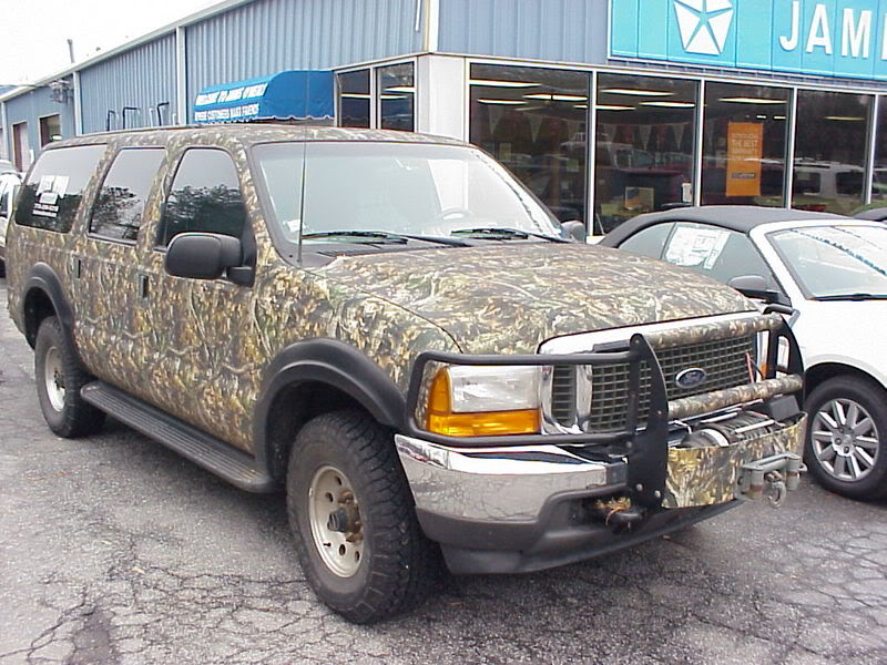

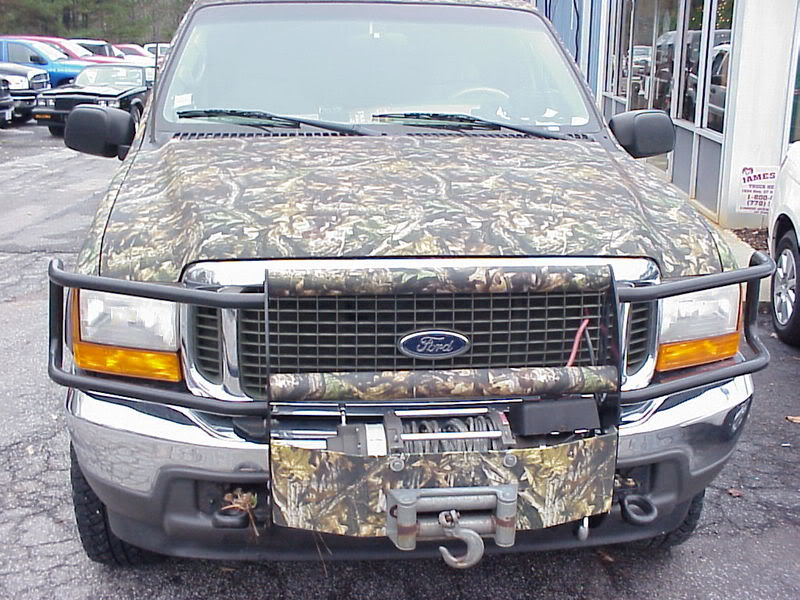

This is an Excursion that Me and another guy at work did. It is a full wrap including the roof. It was time consuming but not as hard as you might think. A good heat gun helps. Also alot of planning to make the openings line up to look seamless. We used 15 sheets of Real Tree Advantage. Each sheet is about $75.00. They make 2 kinds, removable and non-removable. buy theremovable, it is easier to remove/adjust if you put it on wrong. Try this site for the good stuff.>>>>>>> http://camoclad.com/
