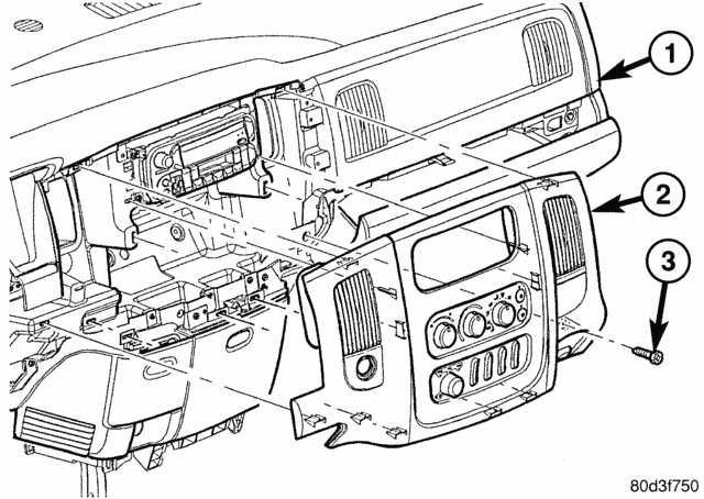

Do you have to take the dash apart? If so how do you do it? I am kinda scared to take it off I dont want to screw it up[&:]

This is very simple on a 2005. Remove screw #3 in the pic and pull on the hook above the removed screw. The trim bezel will come off.
