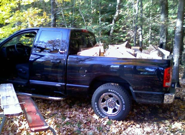

Not entirely sure how much weight there was here, but I'm willing to guess that I'm close to a ton.
Who else can go to a bar, eat for free, drink for free, and leave with a full load of wood...for free...oh wait me! (Did I mention that the bar is owned by my Mother-in-Law?) Oh and don't worry, I only had 2 beers and it was several hours before I drove my most likely overloaded truck 40 miles back home. (BTW hand calculated mileage was 17.4 round trip I've never gotten that good.)
