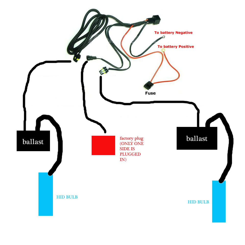

its not to hard to wire the hid's up on an 07 I have one and did it but you must have a relay for them or they wont work on the 07. I have a diagram I made it might help to wire them up

All the dodges have to have the Relay to prevent the flickering and for them to work as you drive you dodge here is a diagram for the HID Ballast and Relay.

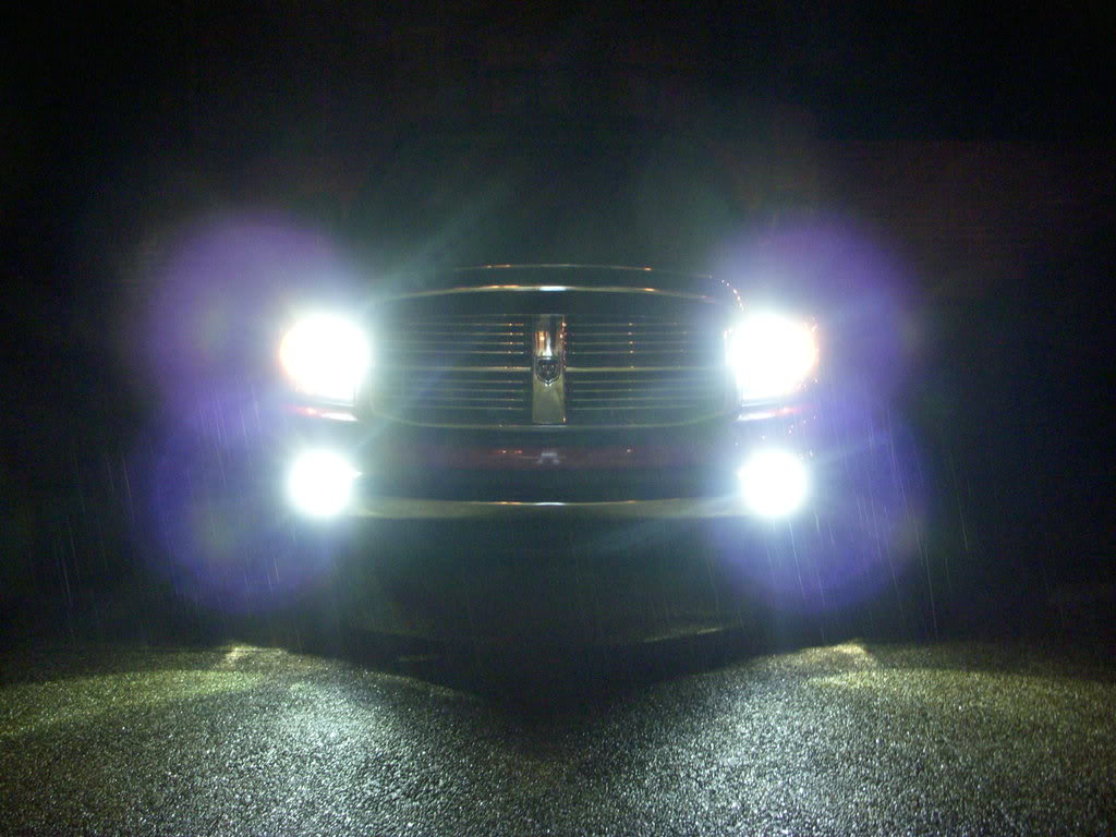

this is what my 6000K Fog and Head Light HIDs look like!
