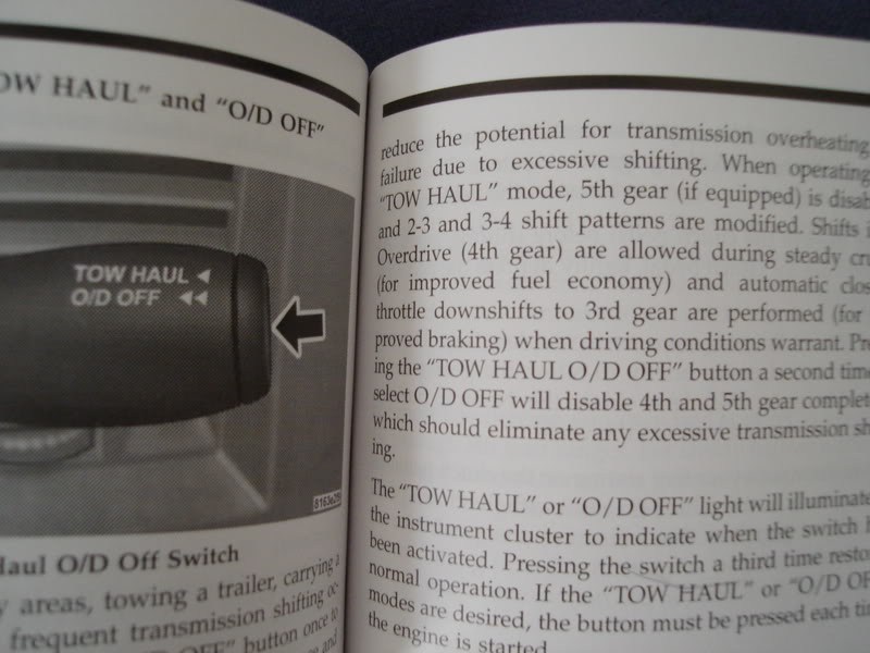

Originally Posted by dirtydog
You do not lose any gears with Tow/haul, just shift points and firmness as well as auto/downshift when you touch your brakes. Helps when going down a hill pulling a heavy load.
O/D off means exactly that. Just knocks out the last gear, not 2, just one.
Wrong...it's in the manual man. What you said doesn't even make sense...both 4th and 5th are overdrive gears so why wouldn't o/d eliminate both? Easy way to solve this...push o/d off then hit the highway you'll be in third the whole time. Same goes for tow/haul...you'll hit 4th eventually but it takes a little bit. The downshift doesn't have anything to do with the brakes...at closed throttle if you are gaining speed it'll downshift.
Originally Posted by Ram4wd
"SeVeReDiStOrTiOn" had it exactly correct.
This is directly from my 06 manual:
"TOW HAUL” mode, 5th gear (if equipped) is disabled
and 2-3 and 3-4 shift patterns are modified. Shifts into
Overdrive (4th gear) are allowed during steady cruise
(for improved fuel economy) and automatic closed throttle
downshifts to 3rd gear are performed (for improved
braking) when driving conditions warrant. Pressing
the “TOW HAUL O/D OFF” button a second time to
select O/D OFF will disable 4th and 5th gear completely,
which should eliminate any excessive transmission shifting."

Originally Posted by Ridinhigh
Can't put it much better than that O/D off just gets ride of 5th not 4th
Nope..if I have to i'l scan the page from the book and post it up. Don't make me do it damn it people .

Screw it
/thread

wow. well, that settles it lol.

That is correct. My 08 works just as the manual states.
Tow/Haul = higher shift points at part throttle 2-3 and 3-4 with 5th locked out at any speed.
OD OFF = No 4th or 5th gear at any speed.
