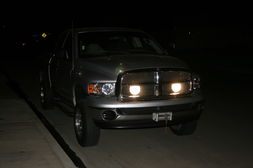

So does this mean that I beat you?!?!?! I just got home from installing mine. Im going to go take a picture right now. I cant really help you too much on the wiring. I ditched the relay, went with 14 gauge wire, and ran it straight to the battery with a 30A switch, and an in line fuse. much simpler.
pics being taken right now...

crappy picture, but here it is...
