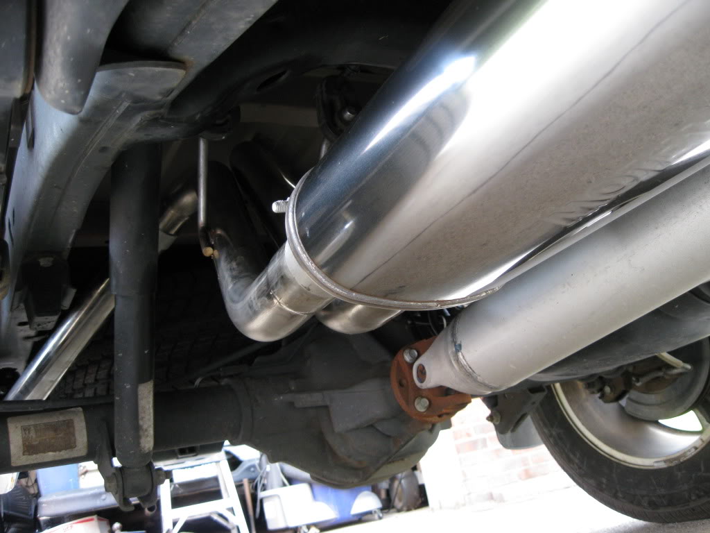

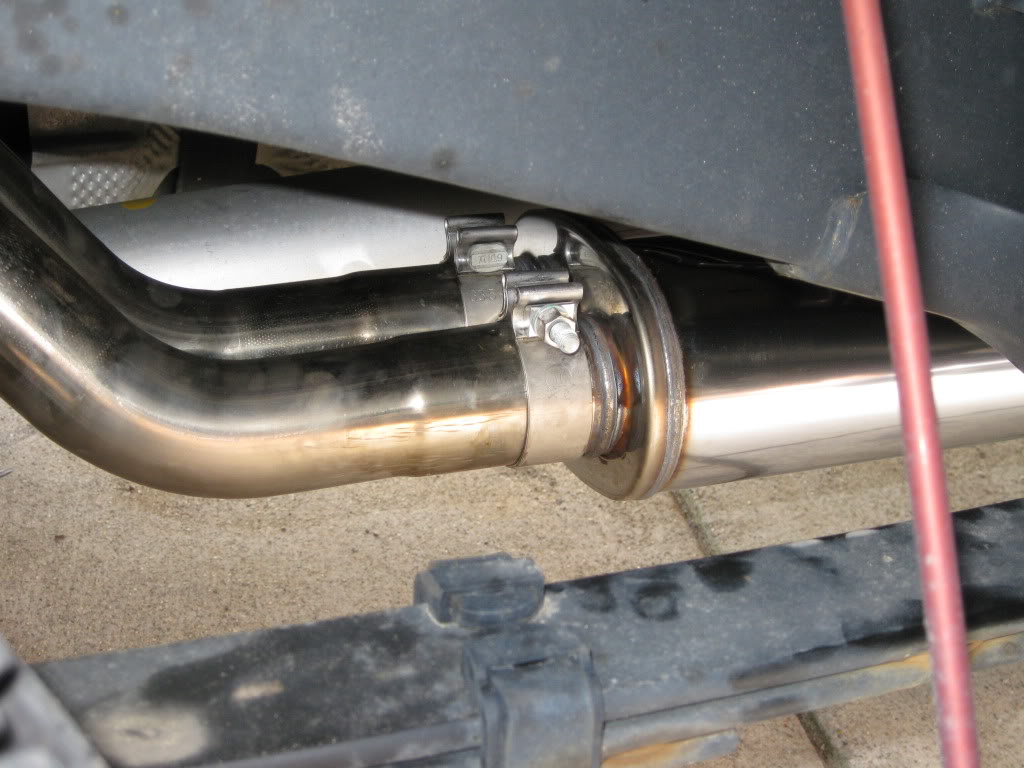

Loosen factory clamps, wiggle tail pipe out of muffler and hangers. Remove said tail pipe.
Repeat for the muffler, remove muffler. If you have a front resonator between the muffelr and Y-pipe, remove front clamp and wiggle mid pipe from Y-pipe.
Install new kit per instructions.
I had no front resonator so I didn't change the mid pipe.

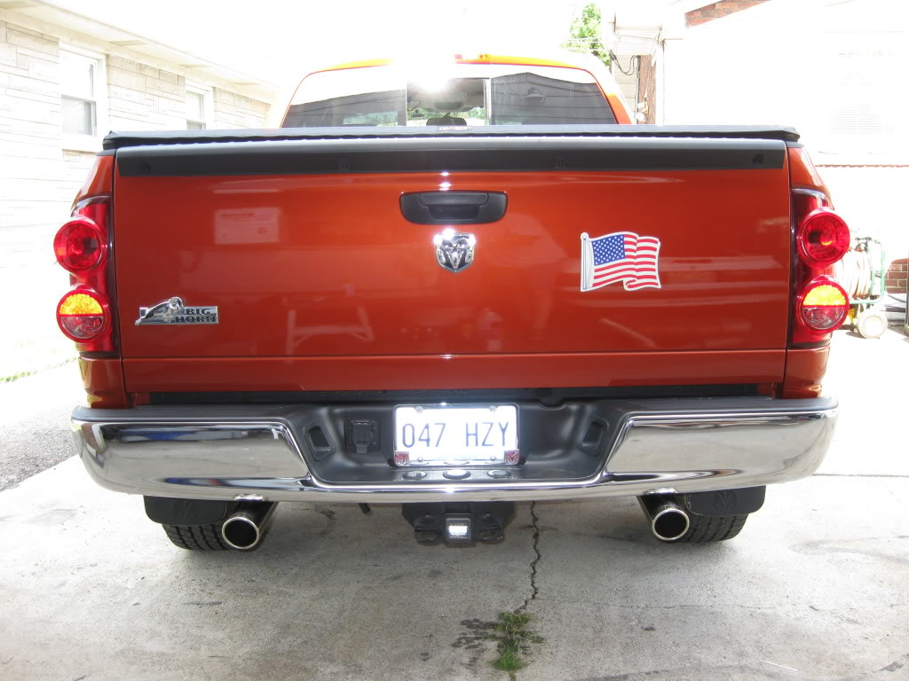

I removed my stock exhaust and installed my Magnaflow 16700 Kit in just over an hour.
