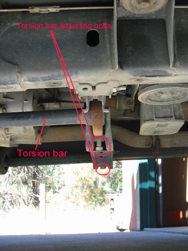

I dont want to get under my truck and start cranking just any random bolts so is there anyway someone has a picture of what to crank on? I've wanted to do this for a while now but i'm not sure exactly how to...thanks

it is real simple find tortion bar end under drivers seat there is only one bolt that can be adjusted on there. then do the same on the passenger side

its really easy to find if you're looking for it. two long bars that have a hex on each end. they start at the front control arms, and go back from there. look under the end closer to the rear, and one bolt will be under it, point up, and you will see something that looks exactly like the leveling/lifting keys do.
I just posted a DIY in the FAQ section. Thought I did one before, but couldn't find it. Musta been I did it on another forum:
https://dodgeforum.com/forum/3rd-gen...ml#post1705262

Thanks guys, i found the bolt and turned it almost 5 whole turns and it turned out beautifully!!
