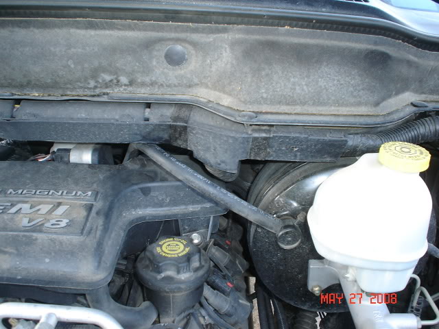

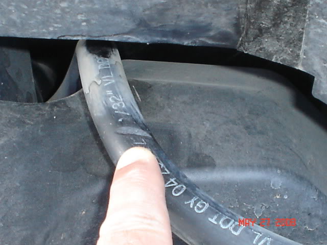

As for your code, sounds like your brake booster isn't getting the vacuum it needs. There is a vacuum line connected from the booster, On the Hemi, if your looking at your engine, it goes to the right of the throttle body, on the side, you should see a fitting. Should look similar and be in about the same location on your engine. Check this line for cracks or a possible loose or broken clamp.
They love to crack anywhere that there is a sharp bend in the hose. I have a couple of pics to help you:
