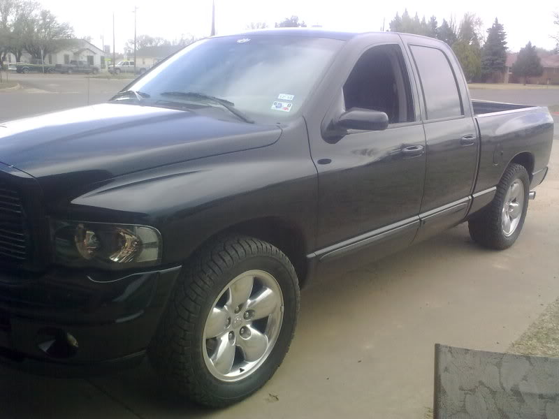

The truck rides fine i just try to take the bumps slower. If i have some time this summer i might remove the o/l. It is completely level with the front. I might not take anything off and ill just take my clamps off.. Sitting low with coopers just doesnt fit my taste atm.

Looks good with those tires...so it seems that you are thinking about something other than the zeon ltz now that the rear is lower? and what do you mean by "I might not take anything off and ill just take my clamps off" ? I like the look so far though.
