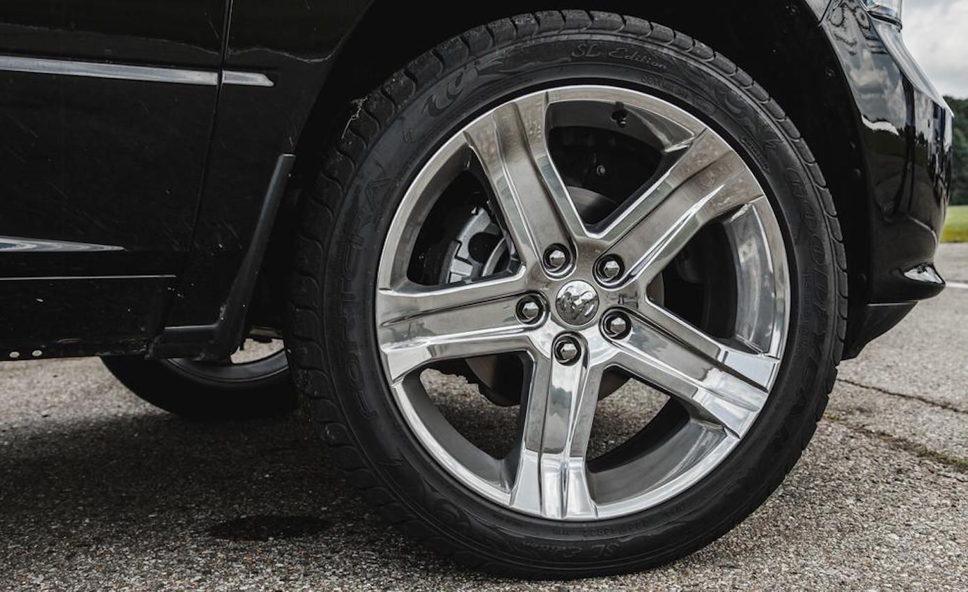

First of all will I be able to leave the stock wheels and tires on temporarily until I upgrade? Currently I have those 20" wheels with 275 60 R20.
When I decide on wheels and tires, what size should I go with? Should I upgrade to 22" and if so what size tire?
Also, I love the newer model RT rims, will they fit a 2007 and if not does anyone know of something aftermarket that is similar?
These are the wheels I'm talking about.
Any advice and input would be greatly appreciated.

Sorry so late answering this: Yes, those wheels will fit. Second, third, and fourth gen wheels are all 5x5.5.

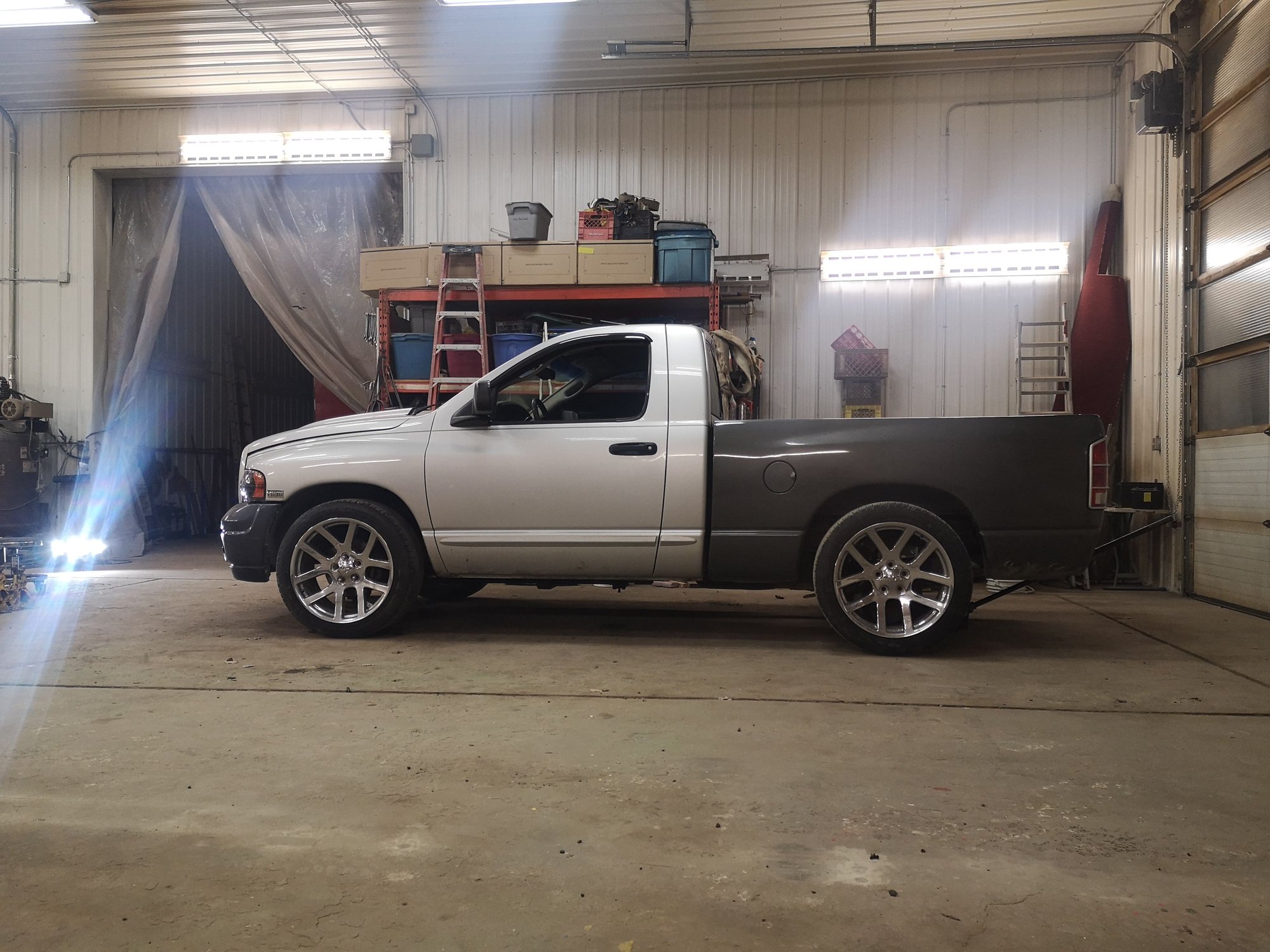

Hey guys looking for info or ideas. Lowering my 2003 ram 1500 4x4. I'm flipping the axle in the rear but haven't yet but for the front I picked up the drop spindles from mcgaughys and it wasn't enough so I unloaded the torsion bars but I'm worried the ride is going to be garbage. Does anyone know of a place or website I can find lowering torsion keys? Do they restore ride quality? Or possibly front shocks with helper springs?

Lowering keys just re-index the keys. They do nothing for ride quality. Lowering the truck reduces suspension travel before it hits the bump stops, and THAT is what makes it ride horribly.
So basically unscrewing the bolts on the factory keys does the same thing?

Yep.
