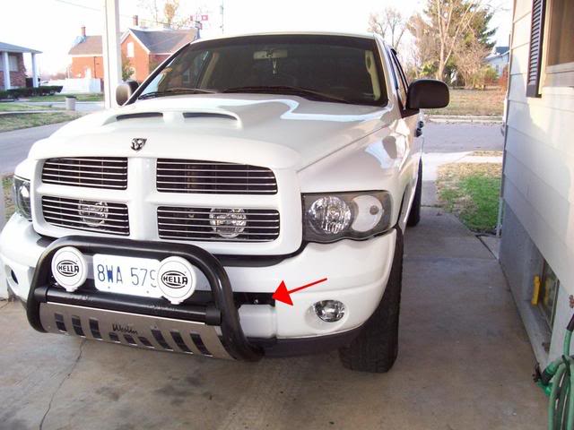

this bumper insert is what we are taking about right?
