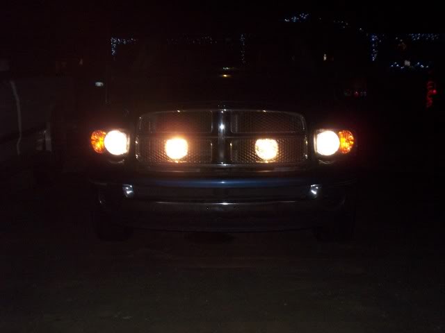

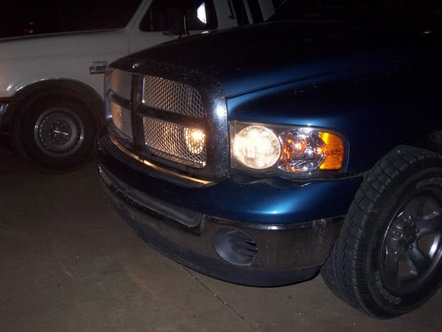

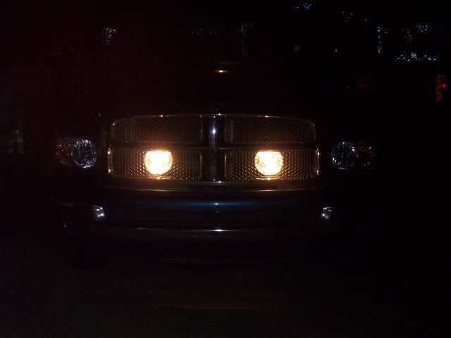

Ok, well heres the finished product! I gotta do some wire hiding tomorrow because it was freakin cold out, and I wanted to get em wired up to see how they do.
Tell me what ya think, and if your any good at aiming lights feel free to give me some tips cuz I suck!

you might need to file down the bottom of the mount to get em to aim low enough. should be something about it in the DIY i think

yeah i think rubberfrog got a nice write up around here somewhere. but they look cool and throw some hids in there next. i just got my second set today as well. deff a cool mod i think
