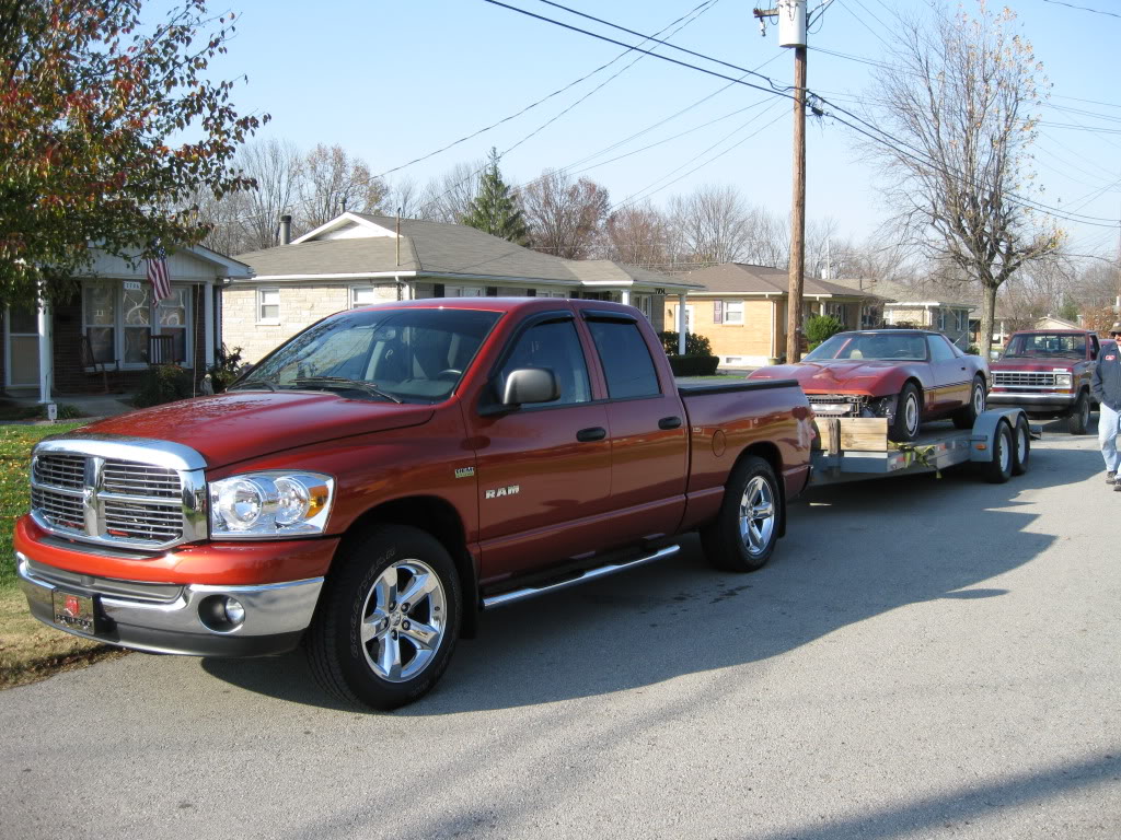

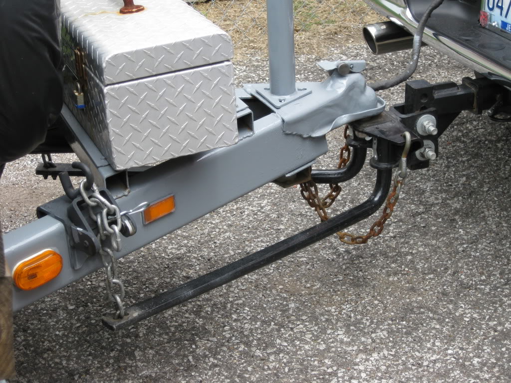

I am all about the WDH. I use one on my 20ft car trailer and it makes a big difference!!
Doesn't squat bad loaded. I could tighten it up another link, but you need enough tongue weight to keep it stable.
