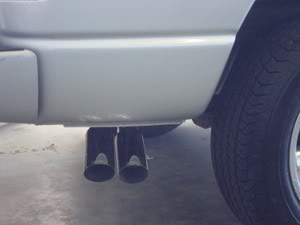

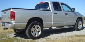

Went as well as I could have expected. Sound is perfect for what I was looking for. Nice mellow tone and not too loud at all. I first cranked it up in the garage and it did not blow me out at all. While some might have been disappointed, I was very pleased. I'm putting a couple of pix below but will be putting up a DIY soon.
However, I've got a little problem I could use some advice on. When I went to put on the driver's side pipe, I realized I would have to drop the spare a little so I could push it over. Well, when I got everything button up and raised the spare, I realized the tire is touching the pipe. And I think, even if I figure out how to rotate the pipes over a little bit, it will still be touching or too close. I called Gibson tech support but all I could get was a sales rep because their power went out earlier and they sent the tech support people home. Pretty knowledgable guy but not who I wanted to talk to. I'm thinking I'm going to end up with 2 options. Either move the spare tire to the bed of my truck (which I don't want to do and is why I did NOT buy the dual extreme kit - because Gibson said I would definitely have to move the spare for that) or devise some sort of effective heat shield. I mentioned a heat shield to the sales guy and he said they have recommended such a thing in some cases in the past but it was not the best option. What do you guys think? If you think it will work, what's the best material to use? Would it help to wrap the pipe with something? He also mentioned that somebody might have something available that would actually move the spare over a little - some sort of bracket or kit of some kind. Anyone heard of such a thing?

I think I just made a rookie mistake and instead of spacing things out, I just fitted everything together as close is it would go. Look at the pic below against the yt vid of the same exhaust on the same truck below. His pipes exit out quite a bit further back than mine do. I should be able to just loosen the clamps and take an extra half inch or so at each connection and get the clearance I need.
I got nothing against Magnaflow and was going that route until I found this and the price was right since I didn't find the deal on the MF's some of you were able to get. But the sound of these are perfect for me, my research paid off, and I certainly don't want to change now.
