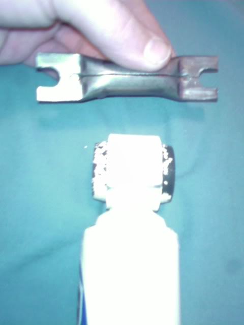

I'm in the process of putting in my leveling kit but I can't figure out how to get the shock mounting bracket to fit through the bushing. Heres a pic any help would be appreciated.

Maybe Im just dumb but what the heck is that thing?

lube it up and slide it in. you might have to give it a good ramming... you know how to do that right?
haha. when i put my roughcountry shocks on the shafts were a bich to get through the bushing. put a little motor oil or silicone spray on them and they should go in...
edit: you are trying to get that metal piece through the rubber bushing in the shock right?

Well I solved that dilema, I took it to my local auto parts store and they popped out the bushings and used WD40 to put in the bushing and they used some kind of press to put the bushing back in the shock took em like 30 seconds. Now I'm having trouble getting the damn caliper off!
