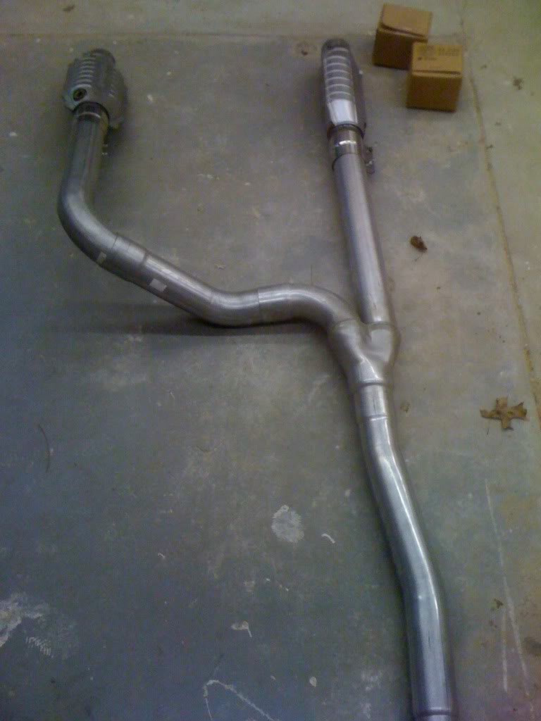

the Y pipe for a hemi ram has two 2.5" tubes going into it, and one 3" tube coming out.
here is a pic of a custom fabricated one:

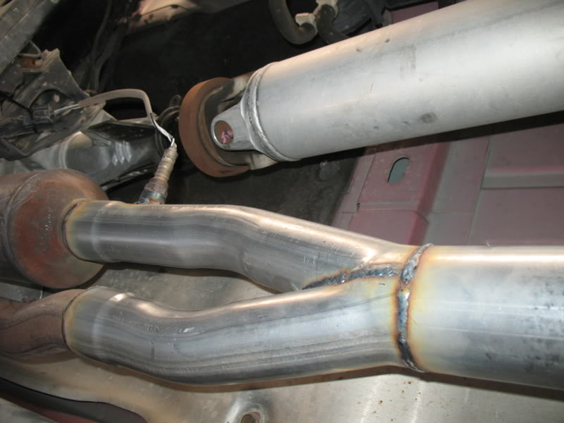

2.5" inlets with a 3" outlet. The rest of the factory Y is fine (at least the 08 is), just the crimped up section where they come together is what needs to be replaced.
