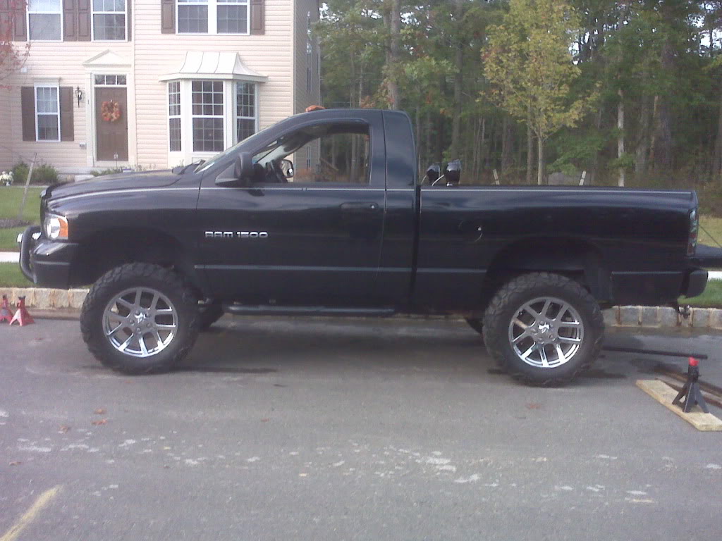

heres mine i have a body lift, took the westin nerfs that where on the truck and cut the bracket back to lift the bars up to the truck so there is no gap

i just cut 3" off the brackets and drilled new holes so they sit at the same height before the lift.
yea what he said thats all i did just modify the brackets for the 3" body lift

i have westin and brackets i just cut 3" off
