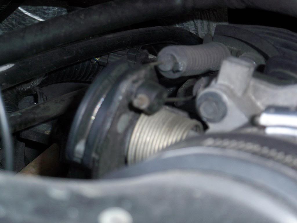

4.7ram...i just unhooked mine not sure if you have the same linkage on your 07vs my 04 but i just rotate the throttle and the cables come out thru slots and the one on the right of the throttle links(bottom pic sorry kinda blurry...) it just pops off if you pull towards the front of the truck becareful not to break it....dont mind dirty engine bay it will be cleaned this week....

Preciate you taking pics Jay. I went ahead and just did it while the bastard was still attached, PITA!! haha, I couldnt even get the dam (vacuum?) line off the right side of it. Tried pulling it, using a flathead to pry it, nada. Stabbed my thumb and all kindsa ****, but, its clean! I was afraid I was gonna mess the linkage up by flipping it over, but I just got home, all seems to be good.
I also took that snorkel tube thingy off my intake box, just to see what difference it made. Between that and the cleaning, seems a tad more peppy, but the sound difference is AWESOME, lol.
Now, the Hemi was a breeze to get off, no problem at all there. BUT, it was FAR worse than any other one Ive seen on here. I still didn't get it completely cleared up, and I 'scrubbed' for 20 damn minutes. And the plenum part is crazy looking: looked like an oil slick in there, and when I reached in with the rag, the sides were real gritty, like **** was burned on there... Can't be good....
ALSO, I understand its somewhat normal for the oil cap to be brownish, rusty looking, but there was a lotta condensation, and smells strongly of gas. Is that normal? Just wondering, Ive been hard on that 'Rango without a lotta proper maintaince, besides regular oil changes. Thanks for reading, and again, thanks Jay
