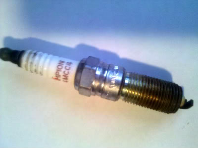

66.5k on the original plugs. They all pretty much looked the same when I pulled them. Like the pic below. I replaced them with the OEM champ copper cores.

also, last post here shows mine looked like after 130,000 miles on the factory plugs. I didnt know they were never changed before! lol

pfft, I wouldnt worry about being 8k over. My truck was 100k over due and it ran fine. The plugs all looked like this. Not the best, but, I'm not a believer in having them changed every 30k anymore.
