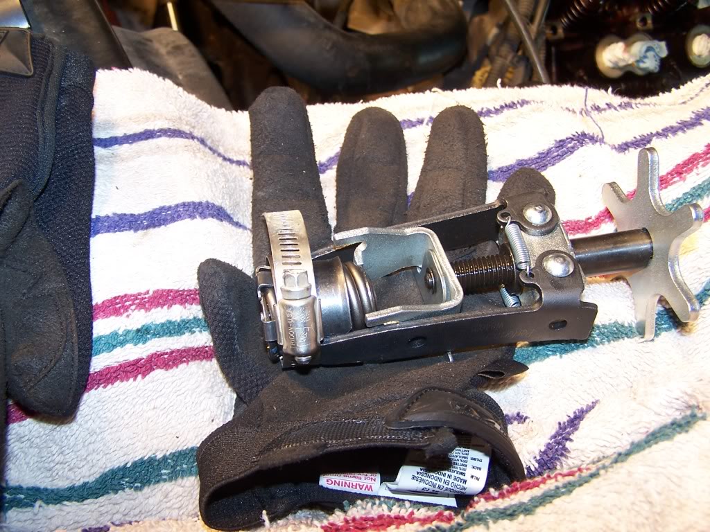

Ok, here's how I overcame the dilemma with the 2nd spring tool that I had in reference to the last pic's I posted. I had to think of how to keep the tool on the already compressed spring and jammed keeper with that goofball metal bucket. Applied as shown in pic's....first put the clamp on while with spring on stem (that was a PITA), got it off, reapplied clamp and spring to tool, slipped compressed spring and tool over valve stem, installed keepers (yep, dropped one, had extra, found dropped keeper)...done....easy fix.

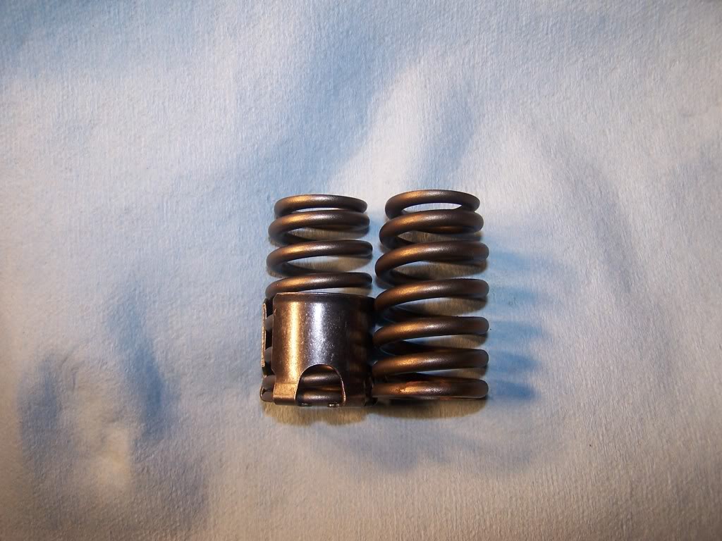

Just to add .... compare the spring out of my LS1 motor and the dodge spring. Sick....just look at the added girth to the LS1. What's Dodge thinking of anyway. No wonder these things break.
