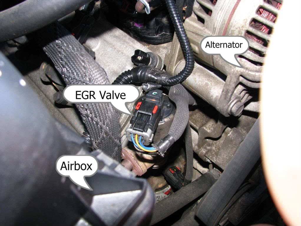

Got a code that says something about EGR position something or other... Where the heck is my EGR valve located? I'm driving a 2005 Ram, 1500, 4x4, long bed, quad cab with the Hemi.

It can wait, but it's a $35 part at an auto parts store and a 10 minute swap out. Yes it's A reason for crappy gas mileage and I'm betting your throttle body is filthy too and needs a good cleaning. That's more of an hour job.
If it were me, I'd swap out the EGR, go rescue the girl and then plan on cleaning the TB when you get back.
BTW, there is a complete how-to with pics in the FAQ section...

Old Mar 23, 2010 | 07:55 PM
JoeHemi's Avatar
JoeHemi
Joined: Nov 2008
Posts: 2,273
From: Pierce County, Wa
