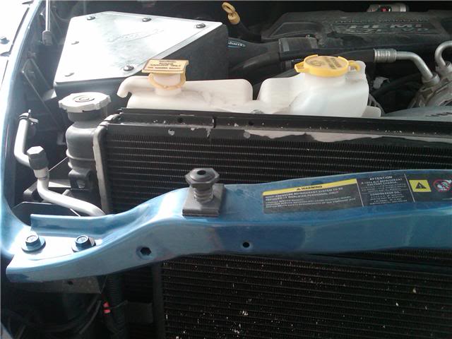

Originally Posted by hoss67
could u explain that a little better for me so i can try it? i sure appreciate it
This lil fella right here
Even after adjusting it up I notice it settles back down and starts making noise again. Your's probably wont but between my steel hood and metal grill they're supporting a lot of weight
Dude thanks for the Pic! that awesome
