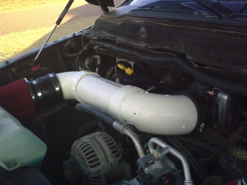

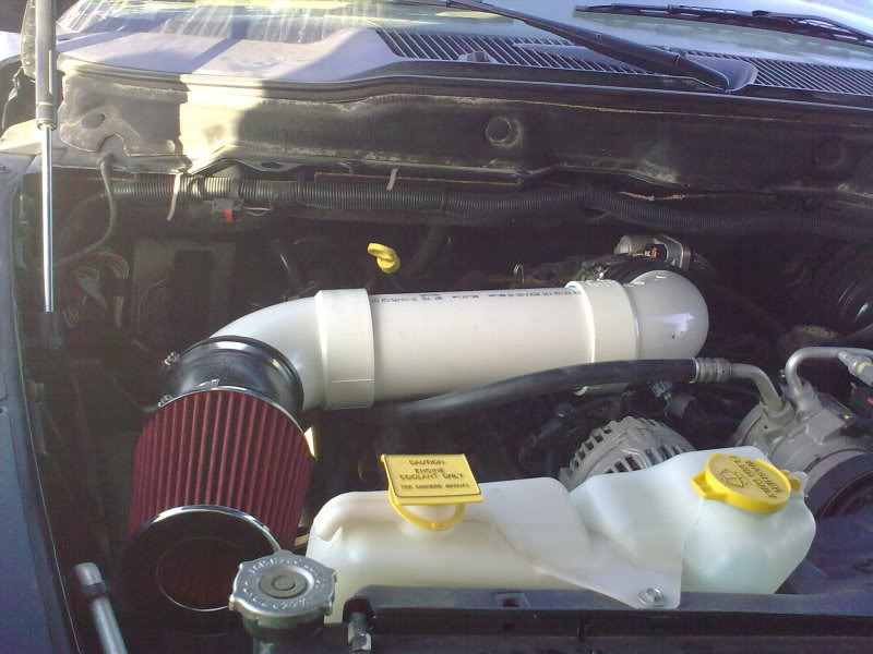

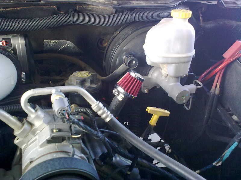

Got back from Lowes and started working on it with my friend.
Here is what we ended up with.
It is all put together and i will be painting it tomorrow!
And boy does it SUCK AIR!!

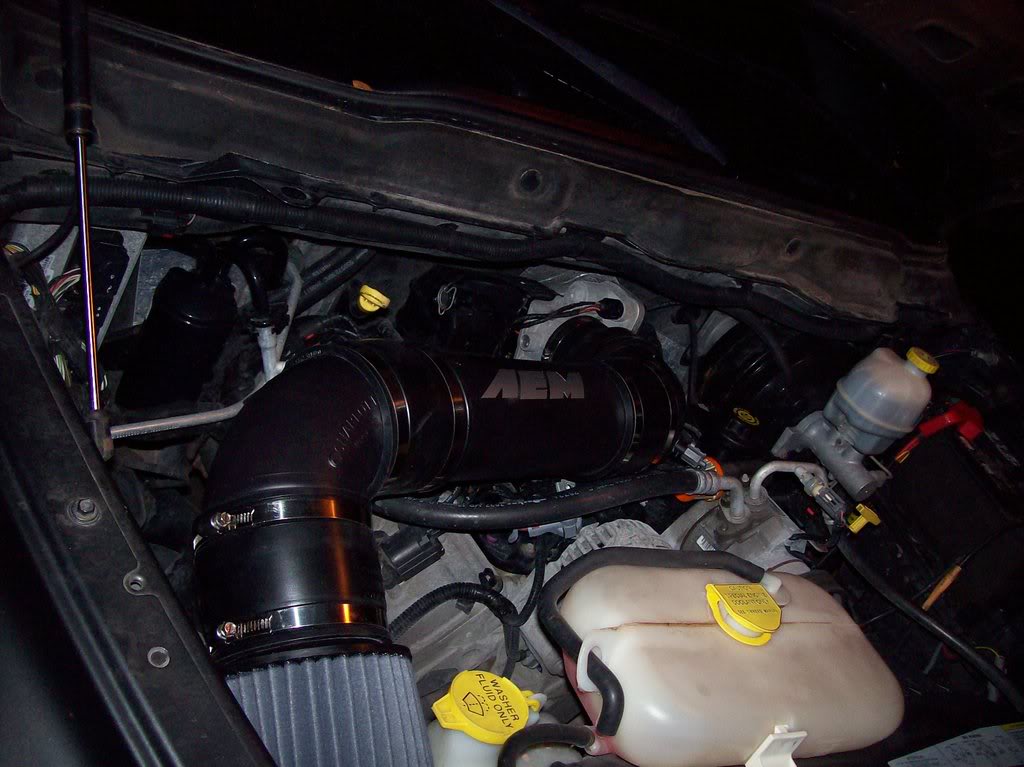

i did the same thing except i used the rubber connector like u have for the filter, for all the bends, just had to cut off the coupler on the bends and it fit like a glove n didint look like pvc just a thought
started with this Name:  100_1238.jpg
and ended with this
haha sry i just like posting pics of it

Hey no worries i just hope my intake turns out looking that good!!!! And that is a great idea with the rubber couplers!
What kind of paint did u use?
ZW
Old Apr 9, 2010 | 10:09 PM
draco8494's Avatar
draco8494
Posts: 731
From: Inverness
i used some header paint from advance, says it keeps headers cooler, kinda like header wrap...so i figured it could keep heat out?...old intake got so hot you couldnt touch it..it was also chrome aluminum crap...i still need to build a block off plate from the rest of the engine compartment...

Take that small filter off your oil filler tube and reconnnect it back to the intake. There is a good reason where is vacuum on that line.
What is the best way?
