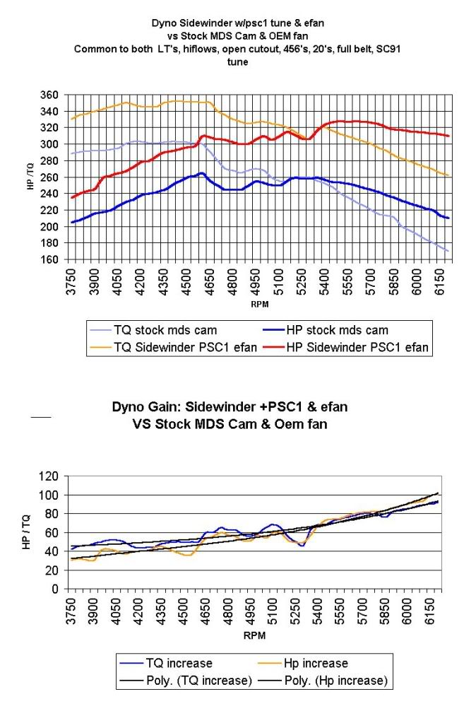

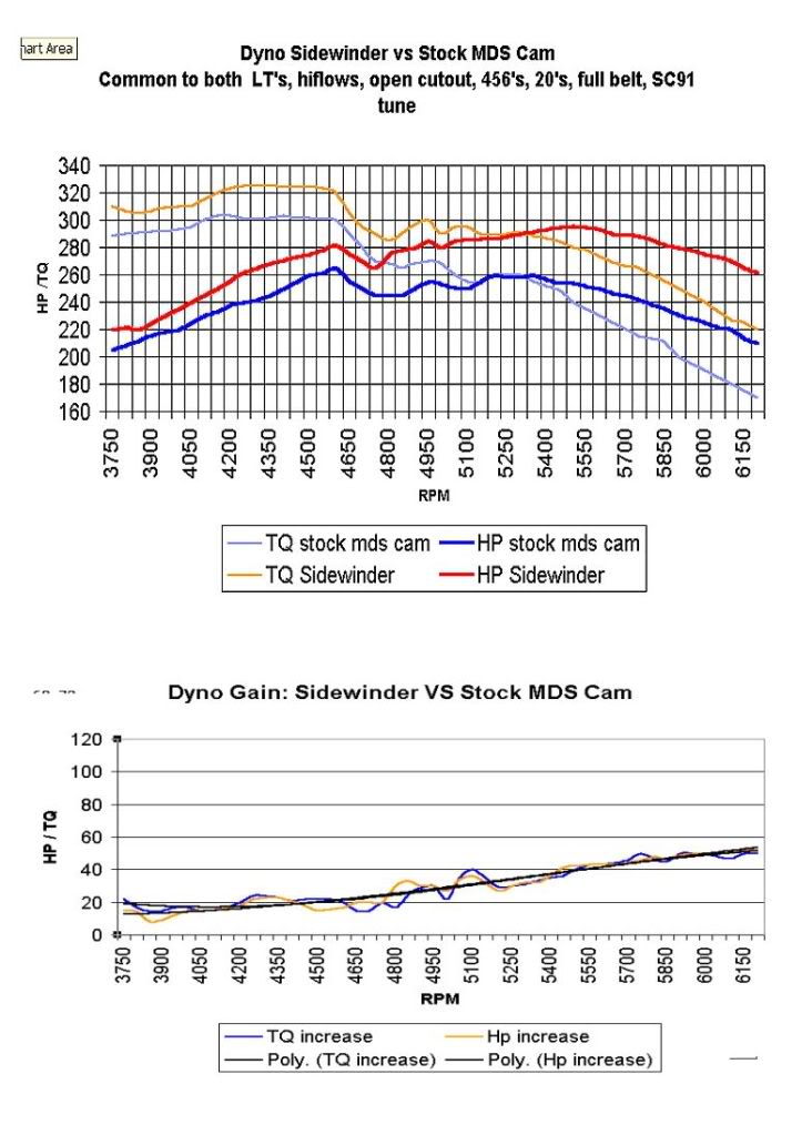

this is another guys dyno from another forum
Here's a couple of my dyno graphs superimposed to show the gains.
The baseline dyno was with the 20's, pacesetter LTs, dual hiflows, ypipe, single cutout, and the regular belt, 4.56 gears, APS 2600 TC, Superchips 91 tune and airram's power wire. (stock mds camshaft stock springs pushrods etc)
FWIW I'd estimate that the TC is hiding at least 20 HP from the dyno based on even earlier dyno comparisons where the LT's plus the TC only increased dyno HP by 10, but had significant gains at the track.
That "stock cam" dyno was done 7-28-2007 ( = 262 HP - 302 TQ. peak)
Anywho, I've put together 2 sets of graphs, to approximately show the gains.
This first set is of that stock cam baseline VS. after the install of the Frank Racing Sidewinder camshaft, 6.1 springs and pushrods with no additional tuning.
(9-29-2007 = 292 HP 321 TQ peak)
The bottom graph is the gain at rpm with a couple of trend lines to generalize the curve.
Power gain over stock cam was 30 hp - 18 TQ at the peaks approx 50 hp& 47 TQ at 6000 rpm.
This second set is comparing that same stock cam baseline to the Sidewinder after installing a PSC1-003 and doing a little WOT A/F tuning to ADD fuel, Also the stock OEM mechanical fan was replaced by an efan prior to that most recent dyno.
(1-26-2008 = 328 HP 352 TQ peak)
Again the bottom graph is the gain at rpm...
Power gain over the stock cam: 66 HP 49 TQ at the peaks and approx 90 HP - 85 TQ at 6000 rpm. (almost 100 HP at 6150)

Comparing the 2 sets. (no graphs of that)
Adding the PSC1 to better tweak a tune for the sidewinder ( and the efan mod) netted additional gains of 36 HP 30 TQ at the peaks and a additional gains of approx 42 HP and 38 TQ at 6000 RPM. vs the just the sidewinder cam swap with no extra tuning and the OEM fan. I'd guess the majority of those extra power gains came from the PSC1 tuning.
So for those considering a sidewinder install, even though it does run fine with just superchips, adding a PSC1 on top of it to tweak the WOT A/F returned a very good bang for the buck.
sidewinder is a great cam when tuned well
