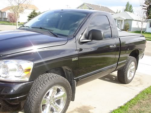

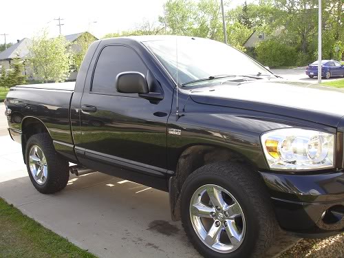

Well i finnaly started it today took me 4 hrs 2 just on the driver side i used a heatgun but i used the highest setting .ooops i caked the glue on the paint took me just over 2 hrs so then on the other side i barly used any heat and i put Goo Gone i let it set for 10 minutes and the tape/adheasive just sliped off i also did the ram log on tailgate what a pain i left the hemi badges and spears for another day but i love it so far goddamit i need to get it lvled and ride of those ugly 20's

Did you use the goo gone first like around the badge then took off the badge or was the badge already off and you just used the goo gone on the remainding residue?

i took off the badge first then used goo gone i found the least head and the more of the tape was left it pealed off better after i washed the area with water then i used a claybar then i used scratch remover .. i still need to take it in to get a prowax job soon still some faint ghosting from badge but a good buff job will take care of that
