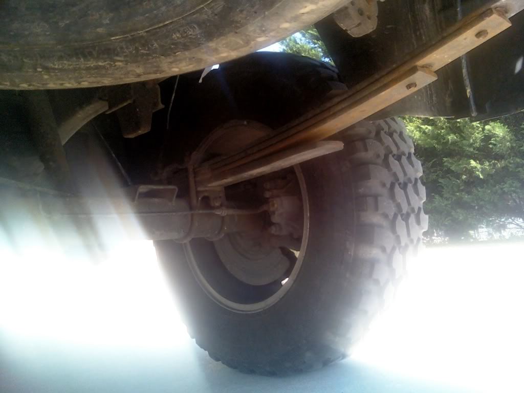

i think his front is 1/2 lower than the back
OP are you sure there are not lift blocks in the rear? that leaf spring pick looks like there might be something in there

here's a better pic of the springs. looks to me like factory spring seat.
if it was just a half inch i wouldn't care, but it's enough that it is noticeable.

ya does look factory

yeah, think im gonna go with the drop shackles from beltech and they add shims under the springs if i need too.

lol lower it and lift it? I hope your u-bolts are long enough to play with shims
