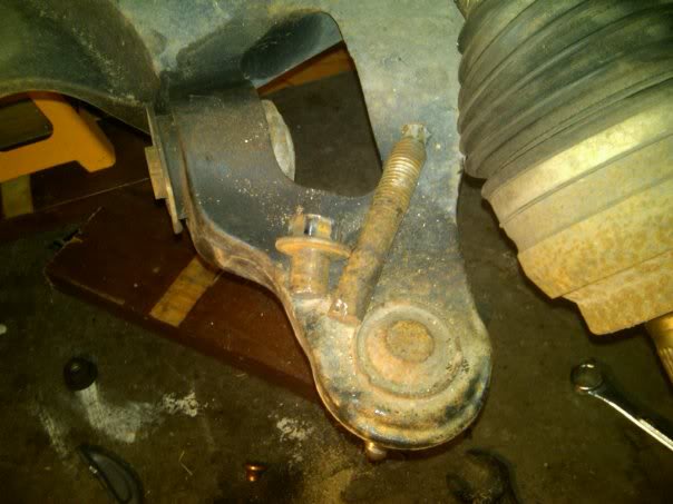

Mine had 0 tension on it and still wouldnt come out. I beat the hell out of it, used an impact, tryed a C clamp to press it out. Nothing worked. There was just to much corrosion built up in the metal sleve thats inside the bushing.
This is how mine came out. Sawzall to the rescue!
