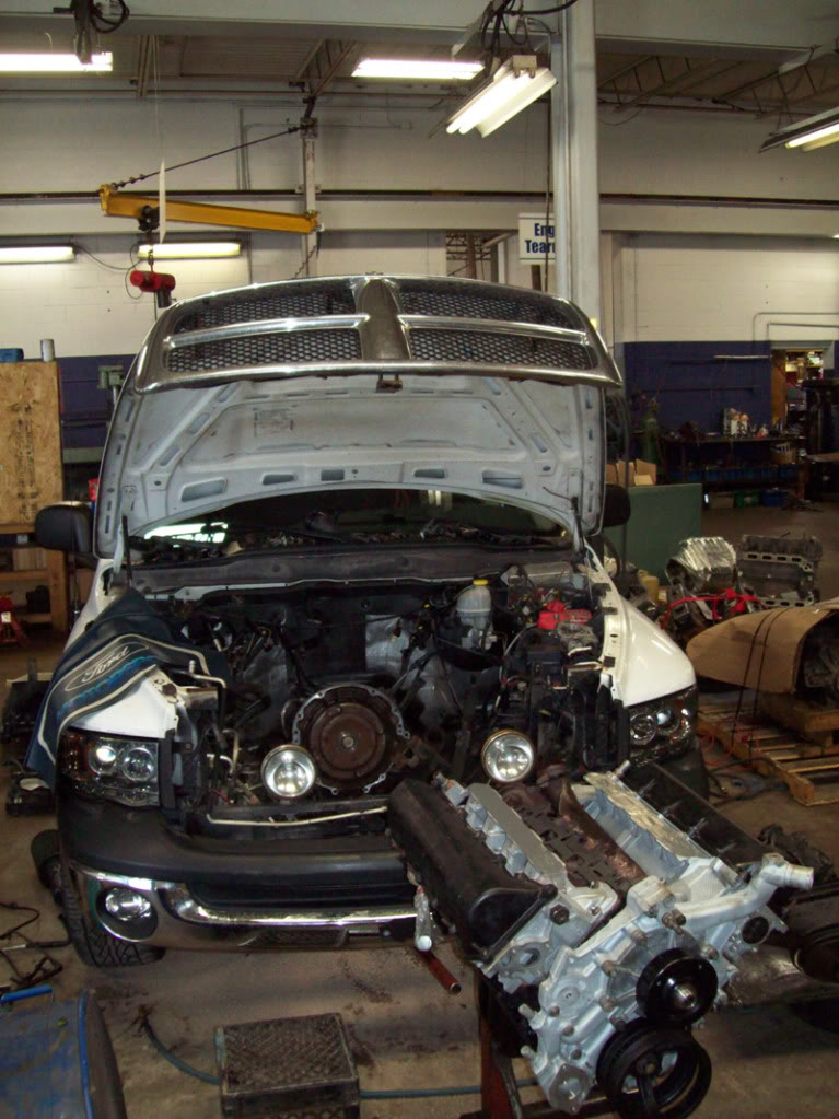

Well, I'm back from my road trip to get my engine rebuilt.
What an AMAZING company. I was treated like royalty! They had my engine out in under two hours and had the new one in by the end of the day! It was late in the day and they wanted to make sure it was fully tested so they paid for my hotel room and gave me a loaner (which was a Sebring convertable!).
I drove home without a single issue! I've been driving it for two days now and it's very responsive and I think my gas mileage has greatly increased!!
Very clean shop, super friendly staff, amazingly fast, no surprises. I am so impressed. I'd give them 5/5 or better if I could!
I ended up with a remanufatured engine with new water pump, egr, fan clutch and spark plugs. They have a standard 3 year / 100,000 mile warranty.
All for $3100US.
Best decision I've made in a while!
Old Jul 23, 2011 | 10:22 AM
  #26
Blueball's Avatar
Blueball
Joined: Jul 2010
Posts: 79
From: Hamilton, Ontario

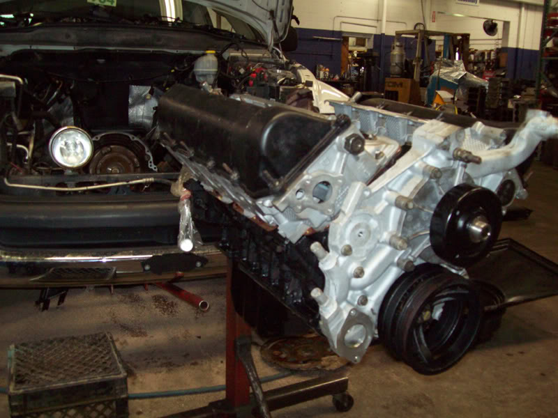

Old Jul 23, 2011 | 10:23 AM
  #27
Blueball's Avatar
Blueball
Joined: Jul 2010
Posts: 79

It is a new radiator. Yes, the old one was clogged and i changed it a year ago.
It was definately a cracked head which led to pressurizing the cooling system. Then the exhaust gasses would vent and take coolant with it. Loss of coolant = overheat.
I think it all started when I towed 4000lbs and had 1200lbs in the box on a 95 degree day .. my fan cluch was very weak and my water pump was failing.
Watch your temp guage! Don't let it get hot!!
