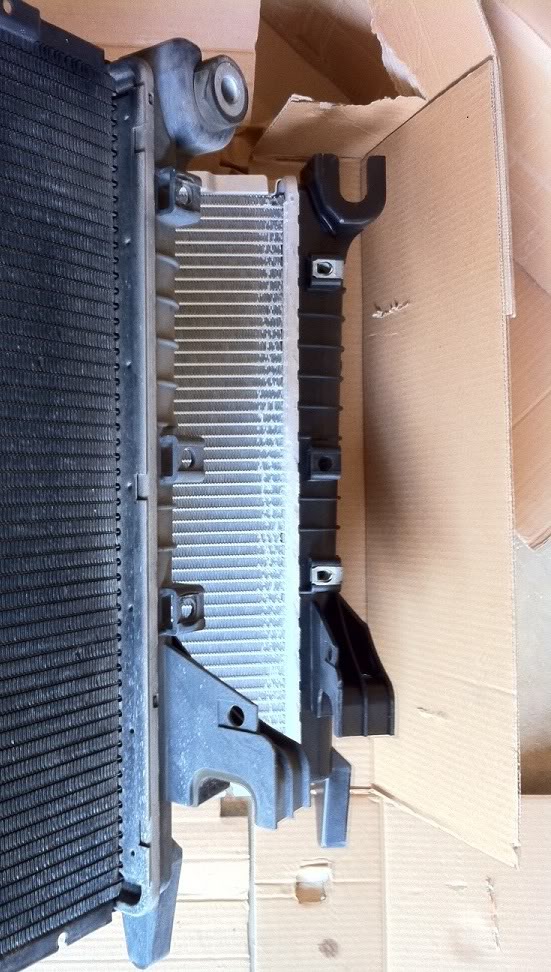

Alright well I bought the new radiator from RockAuto. It was from Spectra Premium, model # CU2480. As you'll see in the pics it was a perfect fit and had all the mounting hardware as the original one, so mounting the power steering cooler and transmission cooler was no trouble at all.
Bottom of new radiator, shows where the PS cooler brackets go.

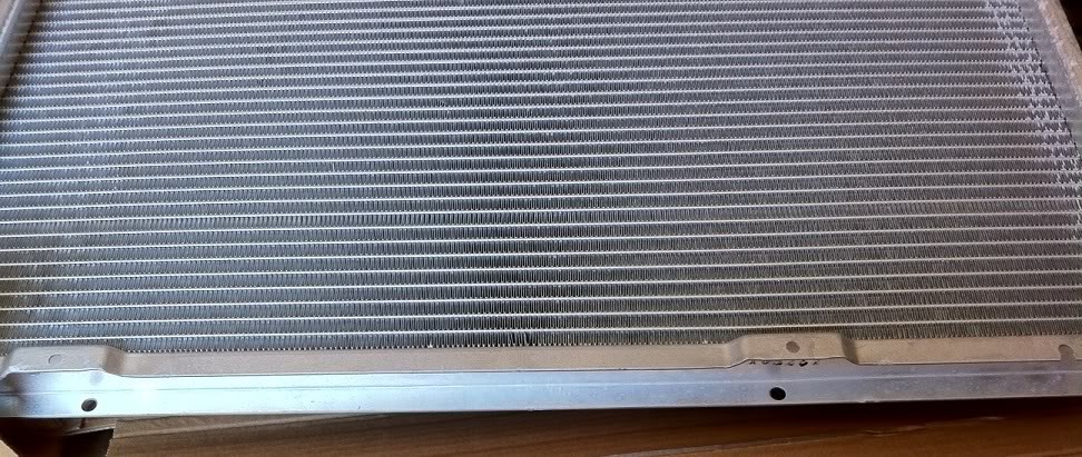

The tabs on the new match up to the old for the mounting nuts

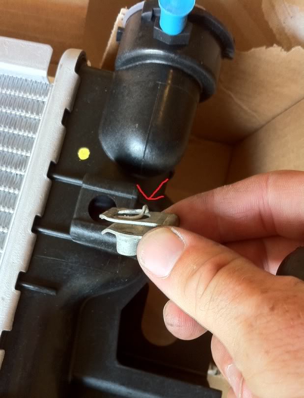

Just pry the metal tap up and slide them out and reinstall on new radiator

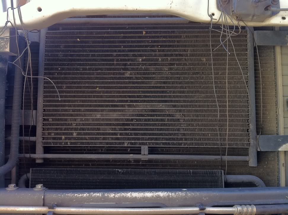

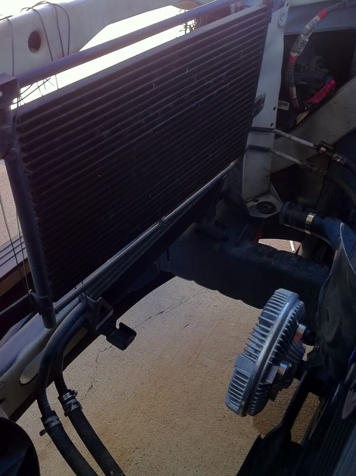

I used some baling wire to hold the PS and transmission coolers in place since I didn't want to pull them out with the radiator. For those with the crappy fan clutches, you'll see I just unbolted the fan blade from the fan clutch, so all that stayed in place.

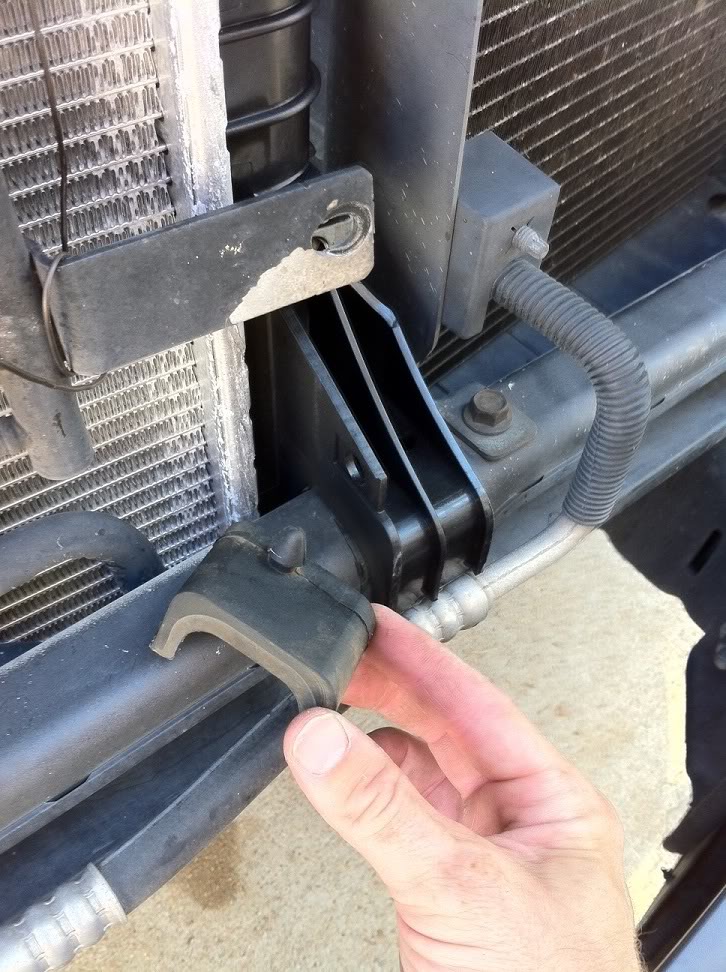

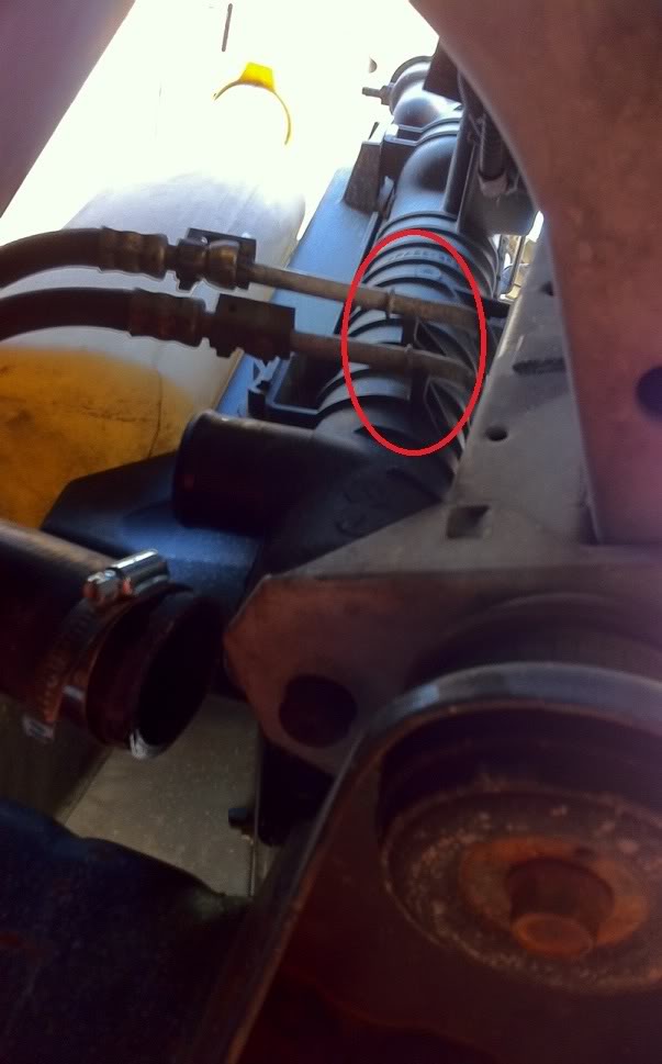

As you unbolt everything, don't forgot to unhook the transmission lines from the clip brackets on the radiator.
Fan shroud removed no problem, notice how the fan blades are loose and out of the way, once the shroud came out I unbolted the power steering cooler brackets and pulled the radiator out.

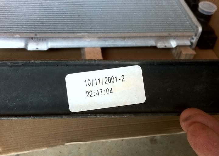

Original radiator. 192,700 miles of service, 5,230 hours of run time.

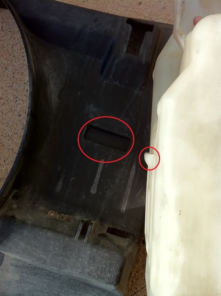

Aahhhh, that's why the stupid washer fluid jug would not come out, there's a hidden locking tab.
