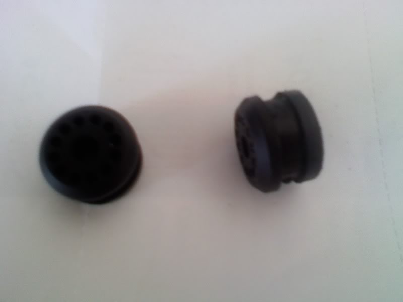

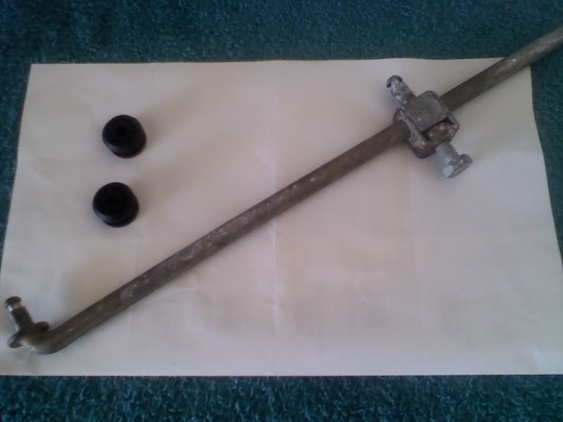

Just picked up my grommets! I'll be heading outside to install them and put my linkage back in here in a few.
I'd love to get a pic of the shifter and transfer case without and then with the linkage, but my suspension lift coupled with the driveshaft is very much in the way of any type of view. I dunno if I can get much more then the shifter side, I'm gonna have a hard enough time getting up to press the grommet on the transfer case side.
But from Harrison's pic, you can clearly see where it goes and how it attaches...
and these are the little son's of b*tches that are the key to being able to shift from 2WD to 4WD!!!

Well once again I can thank r6express because I would have probably tried to press them grommets in with my fingers and had a hell of a time. As in his thread, I used a set of channel locks and they literally popped right in.
It would have been a five minute install but on close inspection, that linkage shaft had a little bend in it and I stuck it in a vise to straighten it out. I guess it got run over in the road a time or two.
Truck shifts from 2WD right to 4HI & 4LO smooth as silk.
I reckon I can now chalk this up to a lesson learned...
