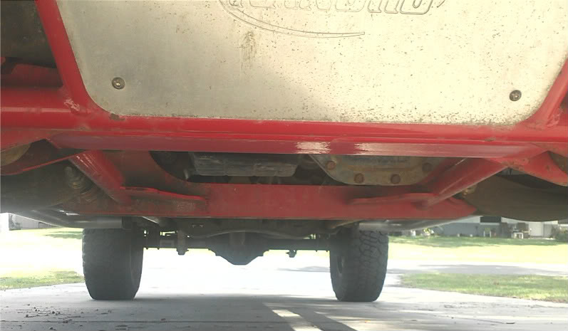

This was the SINGLE biggest reason I went with the Rancho kit when I bought, and trust me, I looked at just about all of them, even drove a few trucks with different lifts. I belong to a hunting club with about 75 members and a good 50 of 'em have lifted trucks, so I really got to ask a lot of first hand questions, look at and drive a few.
Note that the entire lift is supported by a FULL sub-frame. Yeah, it adds weight, a lot of weight, but I felt it was the single strongest kit available for an IFS truck at the time.
You'll also see that despite the 4" lift height up front, the CV angles are relatively close to stock. Also, you'll see the tie rod ends are not stock, they are much larger than the stock ones and are GREASABLE... :

WOW Hammer, the part list on the Rancho kit list does no justice compared to the size of the plate under your truck lol.
