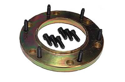

Are you referring to an indexing ring? I'm shocked Top Gunz doesn't know, unless you are talking to some $8 an hour sales person.
Basically there are two ways to keep the transmission/transfer case/front drive shaft in the proper positions when doing a suspension lift. One is to use a cheap transfer case drop kit (usually a couple of "L" brackets), which is kinda cheesy since the lift you gain you basically give back (or at least the ground clearance portion of it) by dropping the transfer case down. Better kits re-index the transfer case with a ring, which keeps the angles correct without lowering the transfer case.
With a 4" lift, dropping the transfer case is minimal bu I wouldn't have a 6" kit with a drop bracket myself.
Does it look like this?
Here, this will tell you about what it (and the seal adapter) is and where they go and a good read also:
http://www.jegs.com/InstallationInst.../825-IXR10.pdf
