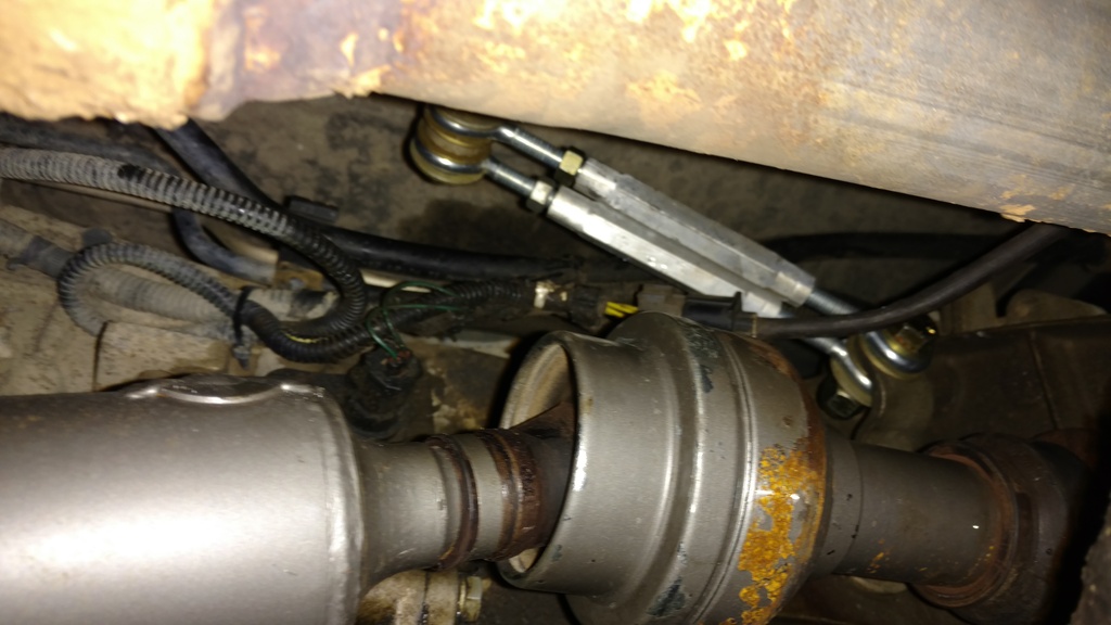

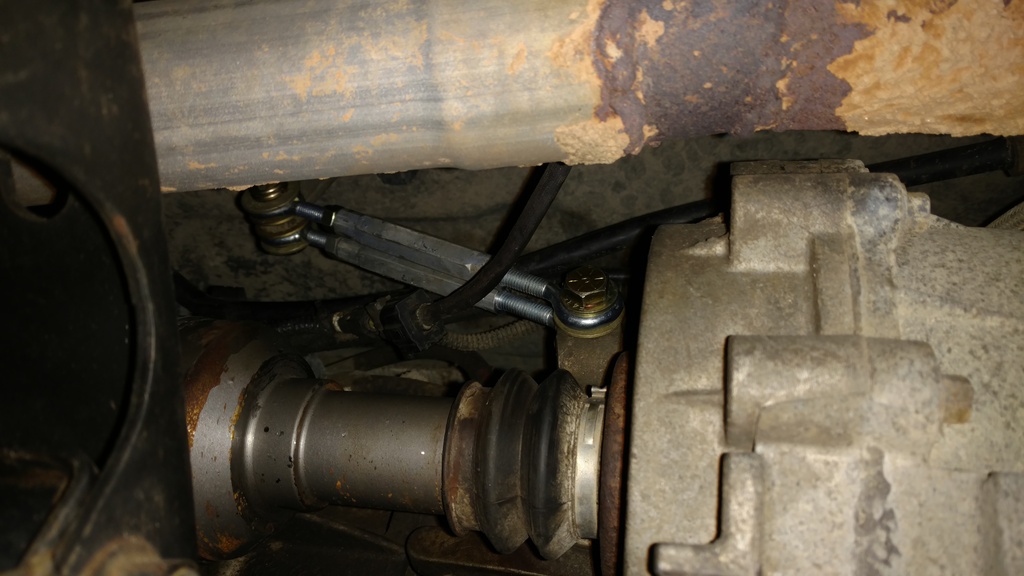

Interesting, I believe your problem is the OG adjustment has come loose, and your shift arm is just far out angled. I just did a revive on this thread, you shouldn't have that much angle. I did this with A turnbuckle and I have a 3" bodylift.

Then further modified it to this:

KasperR34, out of curiosity, why modify your setup to use twin turnbuckles?
