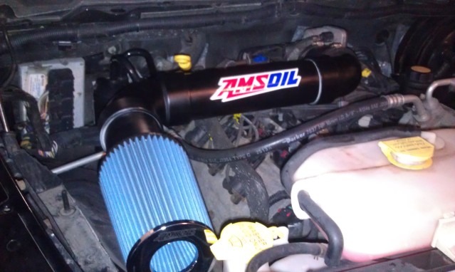

I just took mine off tonight and ended up with this
Still gotta do some touch up painting but it gets the job done and total cost is around 65 bucks.

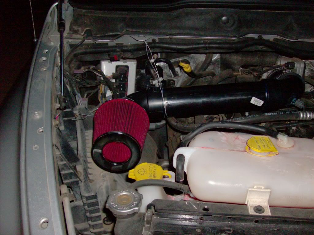

I took mine off but did not like all the nosie. You can make you own pretty cheap.
