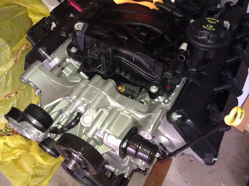

Here is my '06 hemi motor sitting in my garage, you can see the coolant sensor there, shiney and bronze. Its laying down. On my 4.7, however, the sensor is standing up, but its in the same general location.
I can get any pics of the 06 hemi you want, I have a main harness from an 05 too I can take pics of. I just don't have an intake harness.

Oh, and its also possible that they routed the coolant sensor wiring throufgh the main harness vs the intake harness, depending on the year. For instance, my 05 main harness has a coolant temp plug, but the intake 4.7 harness has it.
