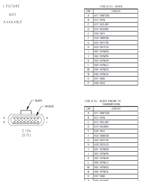

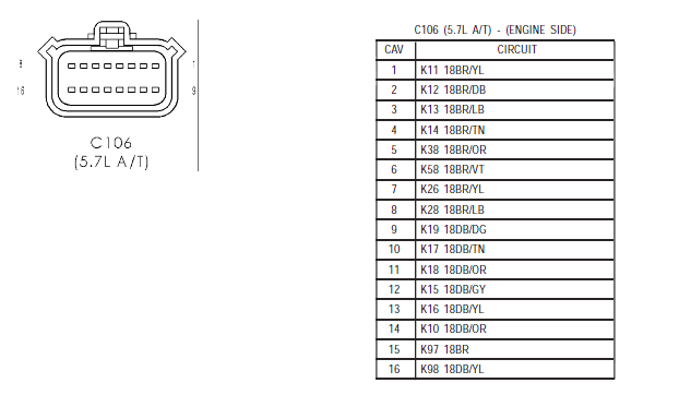

I think I figured out what connector you guys cut up. There is a connector that connects the fuel injector harness to the main harness (C106) and they are different from 2003 -> 2004. Actually there are 2 plugs, but the other one is the same.
I think the easiest thing to do would be to revert the plug on the main 2003 harness and if not use the entire intake manifold from the 2003, at least take off the 2003 injector harness and install it on the 2004 manifold. That will get you in business.
If there is no hope for your old connectors (hopefully you left a little wire on there), use the images below to match up the pinouts. Using colors only will not help you here, especially in different years. Also the 2004 is setup for EGR which your 2003 doesn't have a phyisical connector for, nor does it know how to control it.
2003

2004
