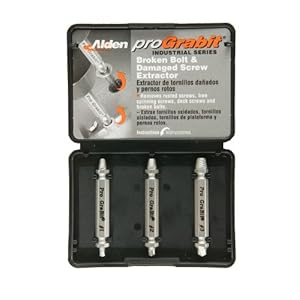

On your broken bolt, I've had tremendous luck using the Grab-Its line of extractors. A set of three is around $20 at Lowe's...
