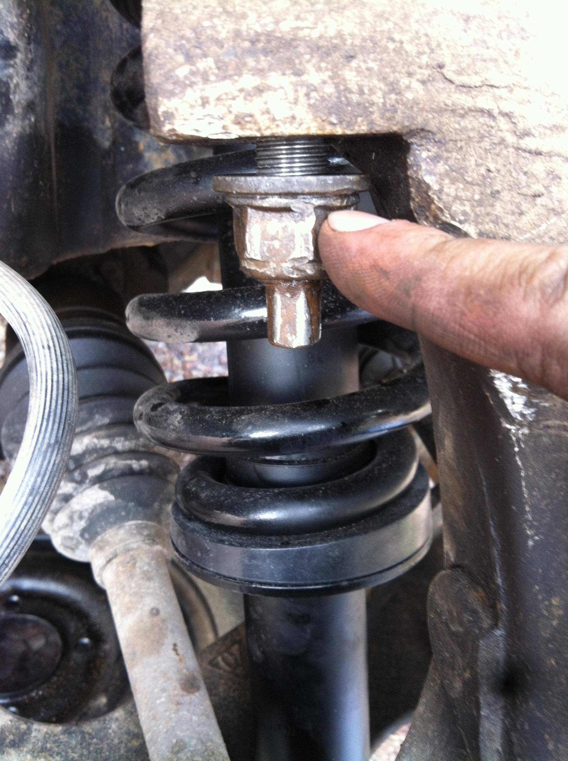

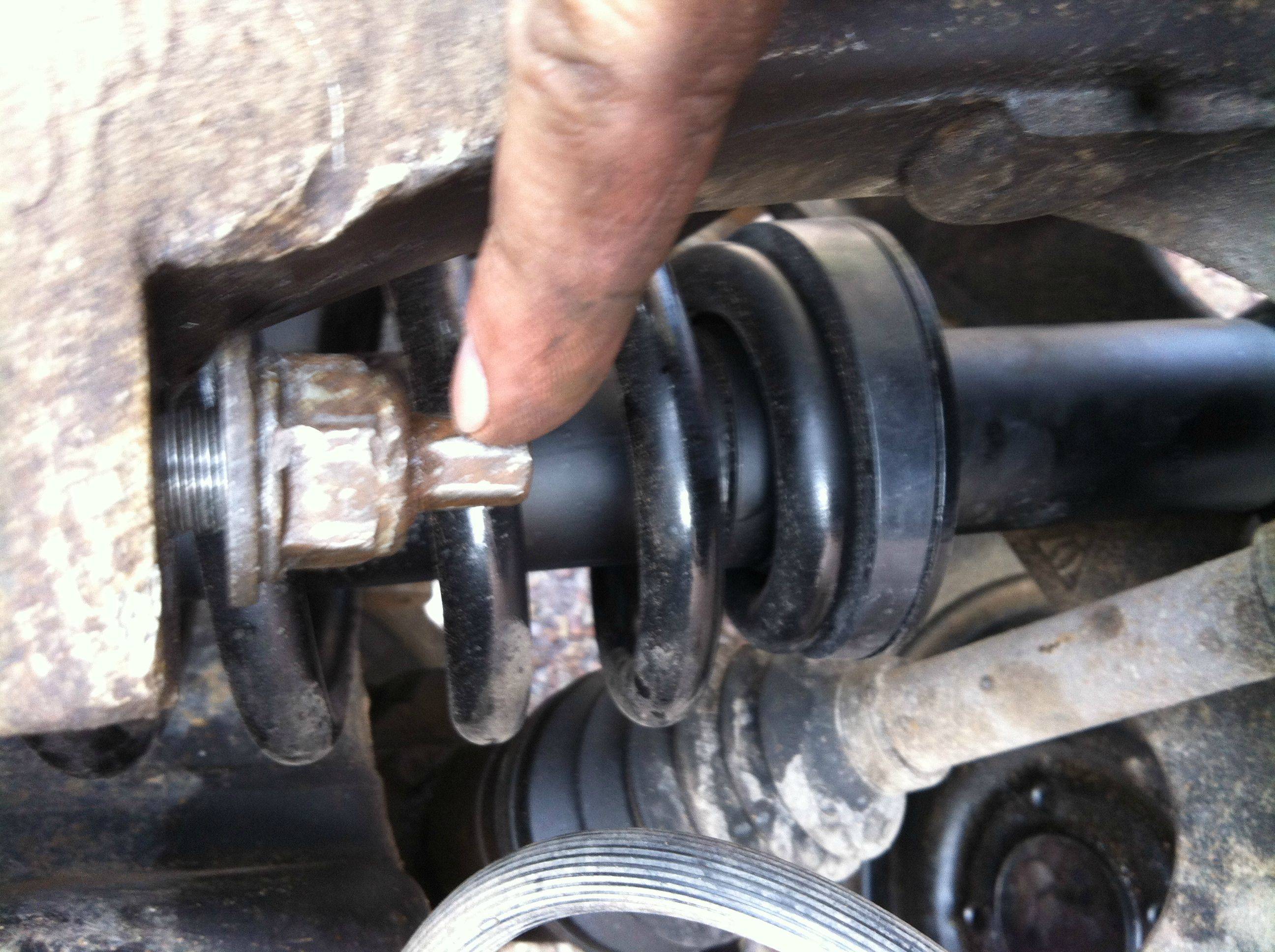

I need to tighten the nut but he shaft moves with it. The shaft it stripped. I've tried and adjustable wrench to hold the shaft in place while I turn the nut but it's not working. Anybody have a solution to this?
Nut:
Shaft(sorry for the sideways shot):

If you are replacing it anyways, take a saw and cut it off. Otherwise, A good pair of vice grips should.

Thanks. I bought some vice grips and that worked. What a pain in the @ss.

An impact would of done it
Old Sep 23, 2012 | 06:38 PM
sabin420's Avatar
sabin420
Joined: Feb 2008
Posts: 697
From: Atlanta, GA
not always...I've had it where it spins with the impact too.
Old Sep 24, 2012 | 12:13 AM
looka's Avatar
looka
Joined: Sep 2012
Posts: 67
An impact would spin the nut just fine, but that wasn't what I needed. I need to spin the nut while keeping the shaft from turning with it. The vice grips worked but I had to tighten them down with everything I had.
