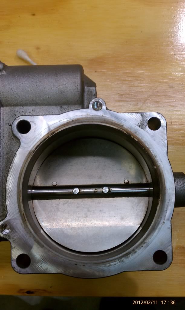

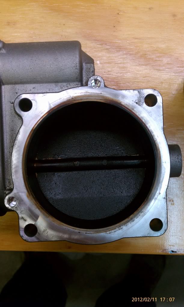

Anyway, I would start by cleaning the throttlebody. They get an oily, carbon buildup on the back side and it can cause the throttle blade to stick shut after acceleration when it closes off to idle down and doesn't reopen fast enough to keep it from stalling.
I cleaned mine awhile back. I wasn't having any issues, just a precautionary thing. I clean it every 30k miles when I change the plugs.
Before
After
Attached Thumbnails 04 Dodge Hemi dies after hard pull-imag0716.jpg   04 Dodge Hemi dies after hard pull-imag0718.jpg
