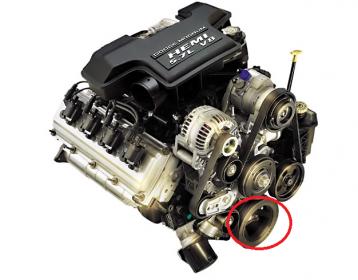

I have a whinning noise all the time with my truck it does not sound like it is the torque converter but i am afraid thats what it might be i am thinking it is a pulley and i have no idea what pulley it is so I am going to put a picture up on here and circle it and let yall tell me what pulley it is and if it could possibly be making the noise i am hearing?

Power Steering fluid is good you dont have any Idea what pulley that is i circled in the picture?

thats your crankshaft pulley, but on my old 5.9L it sounded like i also had a whining noise coming from the same location. turns out i had lost half the ball bearings in my idler pulley. $30 to replace and that was that. i was surprised the pulley didnt kick the whole belt off and overheat my engine, guess i got lucky.

the idler pulley is usually the first one to go... but yes that is the crankshaft pulley...I highly doubt that is what is whining.
