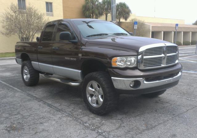

Whats up guys!
I have been off and on the forum over the years since I got my Dodge 3 years ago.Well I just sold that 1999 Dodge ram 1500 5.2 with 250,000 miles on it. I just got a 05 Dodge ram 1500 5.7 Hemi with 70,000 miles.
Its like day and night compared to my old dodge and I am very pleased....Anyways I have a couple of questions about it.
Just FYI, this does have a aftermarket cam in it. I don't know which one but it just sounds like a dragster
1. First gear does not shift till about 2,300 rpms. Is this normal? Seems rather high when I am not even getting on it.
2. Sometimes when I stop it will drop to 500 rpm and jump up when I stop to about 750rpm. Normal?
3. Do you think maybe it has been programmed to different settings?
