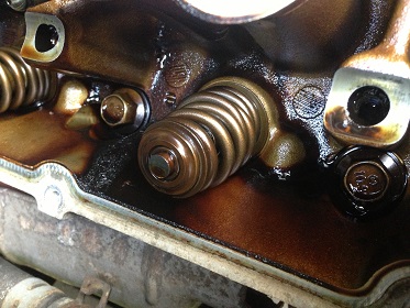

Thumbs down Ouch
For anyone who may be following, I tore into the motor today and found this gem.. Waiting on the new 6.1 springs to arrive and I've put in for a rental from AirRam.com

Throw a cam in it while you have it apart!
