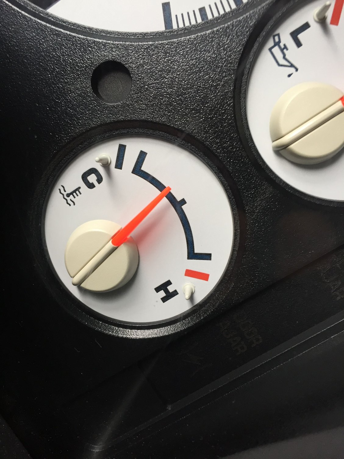

I have attached a picture of where my needle settles AFTER my thermostat has opened. Maybe someone had put in a higher temperature thermostat and im not used to the needle being where it is now after i have replced it with a thermostat straight from the dodge dealer. I also replaced the coolant temperature sensor while i was there. Take a look at the image and let me know what you guys think. Thanks for all the responses, much appreciated.
Old Oct 1, 2015 | 07:00 AM
SmokinJoe02's Avatar
SmokinJoe02
Joined: Feb 2013
Posts: 470
From: TEXAS
looks normal to me.

That's about where my 180 settled. My 203 settles half-a-needle below the center. My e-fan starts half-a-needle above the center.

That is fine. Mine runs close to that. In the hot summer, It runs a little closer to the center. When there, my tuner shows it to be at 203* which is where it should be. In the cool/cold months, it runs about where yours is now.

That is normal and about where mine is as well. Sometimes it moves toward the middle but then back to around 11 o clock. My gauge was going way past the middle and that was the cause of a falling apart T Stat. Took out in pieces. Replaced all is good now.
