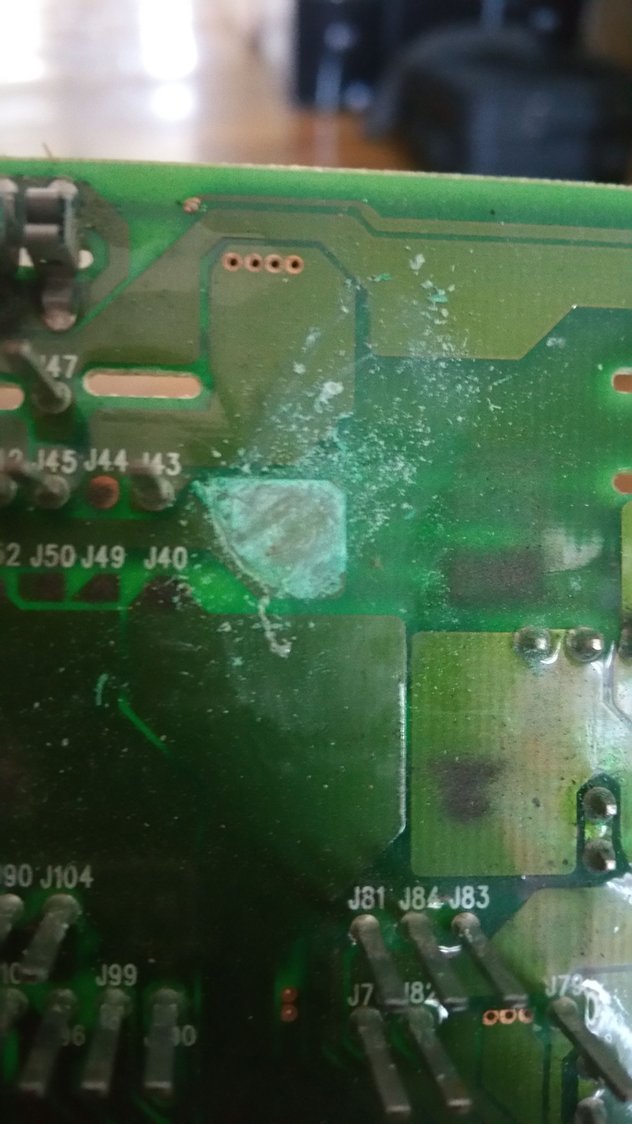

I pulled the PDC out today and dismantled it. This is what I found.

That's what mine looked like too! Didn't fix my issues though but it needed it either way. Also found out dodge makes a lower cover to put under the module to protect the wires from moisture.

I don't know where to go next? Maybe the FCM fried? Like I said, it worked fine one day, then the next day is when the issue started.
