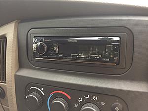

Hey, no kidding... got a new Kenwood head unit for $145 and free shipping on eBay... and not their cheap model either... eXcelon KDC-X701. Also changed out the speakers to Infinity speakers for about $130 for all four. Hard to beat those kinds of deals. And the head unit does so much more than the stock radio ever could.
