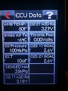

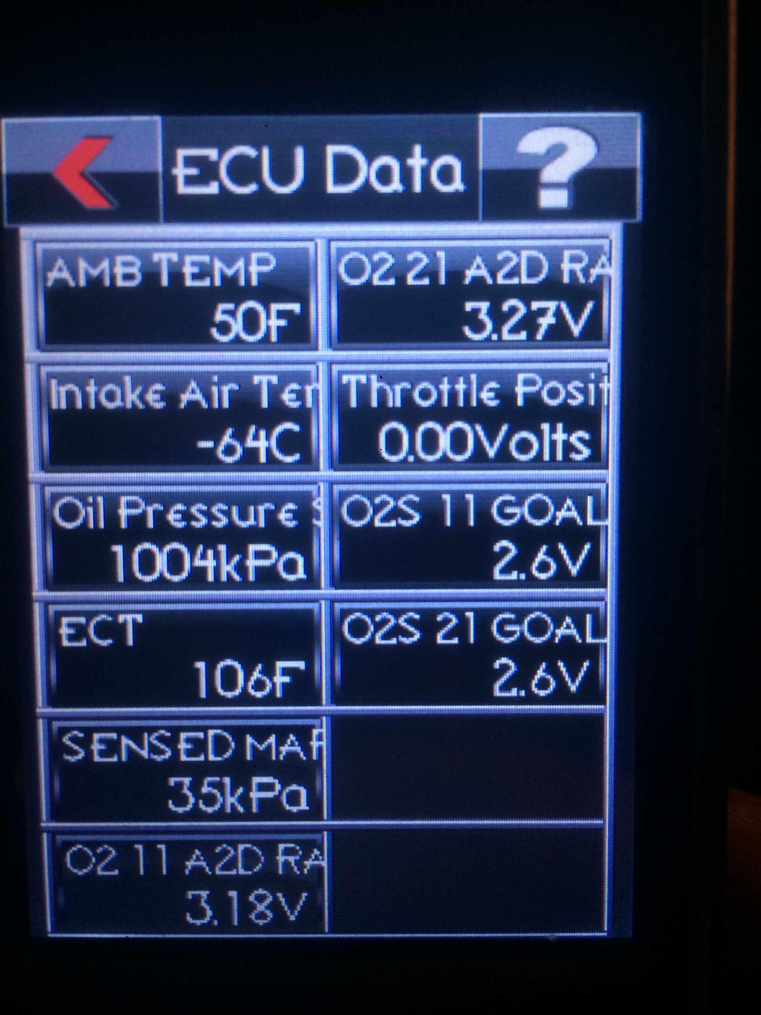

Does this help or mean anything? It looks like I can use this device (inTune1000) to select and display/record different parameters. I have no idea which ones to pick off to display and record to see what sensors are working or not.

Well, is was -42C a few days ago, lol! Yet no, not -64. I have noticed that box, Intake air temp, has always read really cold -64C perhaps -68C once. Truck runs, and runs good, so I haven't really gone ocd on the data in the tool ... yet. But a fit is creeping up on me, I can feel it.

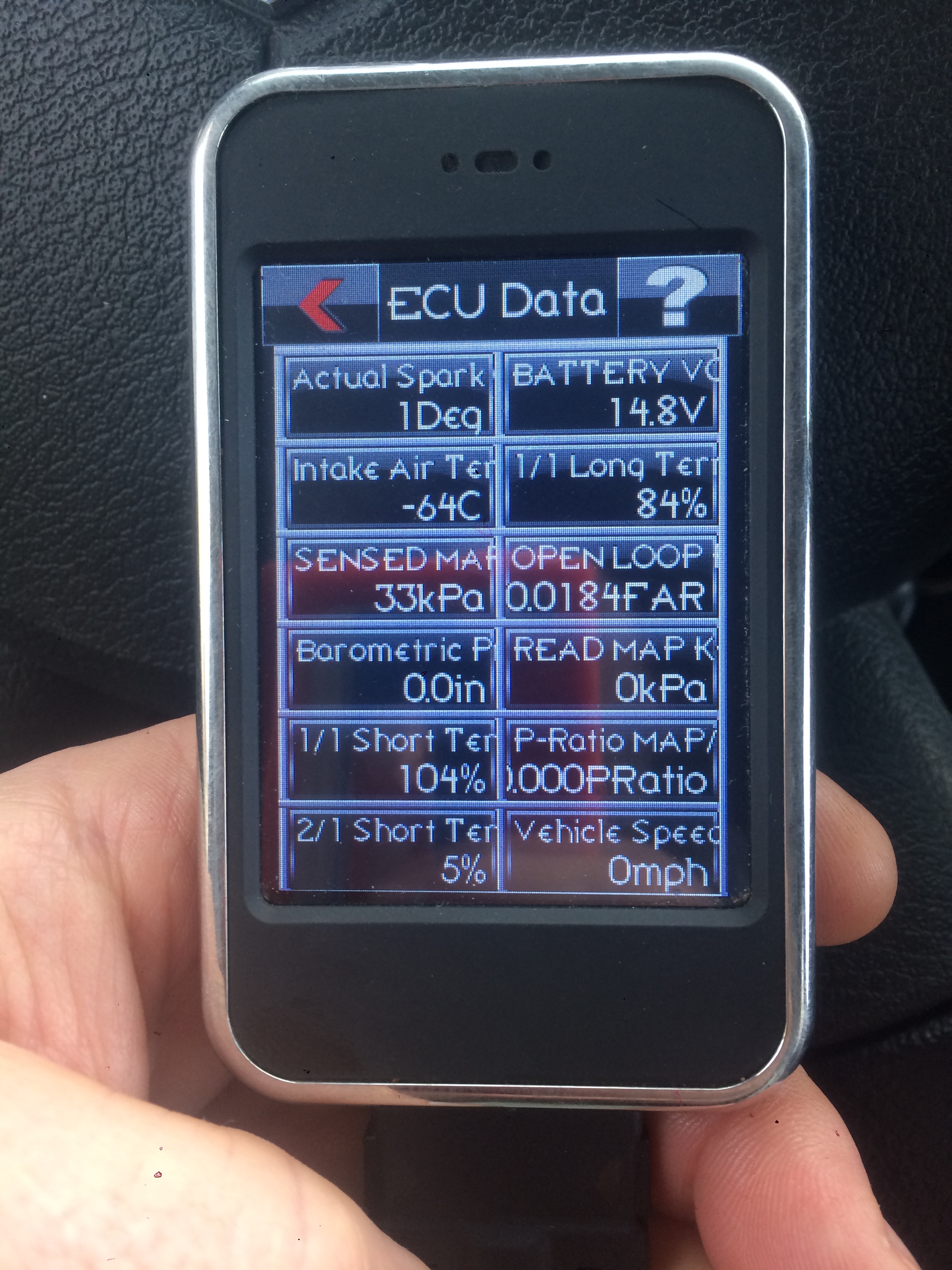

I played with the Diablo a bit today. Figured out how to pull up and display different parameters, it can livestream up to 12 on the screen.
I setup a page to display a few that should help show what is working and what is not. Based on what it was showing me wrt the IAT, MAP, and O2 sensors (rawV):
- O2 Raw have fairly quick reactions to throttle blips, it is looking like they are just fine and I will definitely leave them alone.
- IAT is frozen solid @ -64, it does not move at all. I may have to replace that. Will try some bench testing first. Am I correct in thinking: that the PCM going off O2 responses and is not looking at the IAT at all, normally. ie it is ignoring IAT most of the time.
- MAP is very responsive too, so ruling it as just fine and I will leave it alone too.
Pulled a couple of spark plugs, they are OK but are definitely due for a changeout soon. Gap is normal burnworn open up to about 0.060 now
***** ---> Anyone have link or can post the specified resistance/temperature values for the IAT sensor? I have good 4.95V supply and ground from the PCM on the plug lead. The IAT is showing me 15 to 18 kOhm at room temperature. It goes up and down a few kOhm testing with a hair dryer. So it appears to be working, however it may be operating out of range of the spec. I would need a chart or data table to verify. ... If the sensor tests as good, then that -64C has to be ruled as the scan tool looking at an incorrect data/sensor point. .... UPDATE: yeah, I went through the long menus on the tool, found other inlet air temperature parameters and selected them. Those other ones are showing active temperatures that are more in line with actuals. Therefore, IAT sensor must be just fine too.
