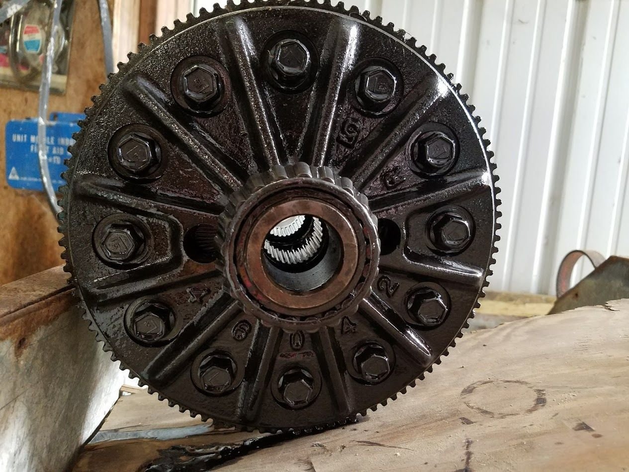

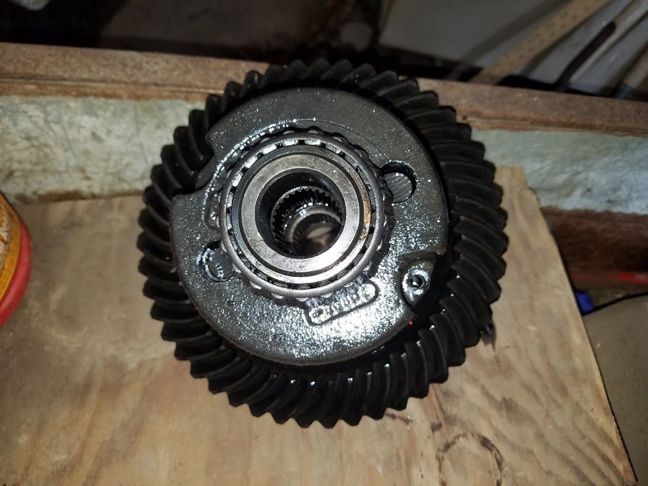

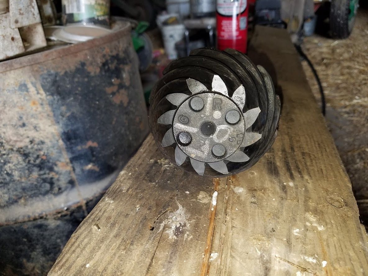

This is getting even more confusing, it is a 2004 1500. The slip in the glovebox states a 9.25 Corporate 3.73. I have it torn apart and did take some photos, I cant find any more information on it though. It looks like it is a 3.92 diff according to the teeth. Not sure how to take it.
12 teeth
12 bolt
47 teeth

Looks a lot like a 9.25 to me..... and likely 3.92 gears.
Thats what I was getting from the teeth on the ring and pinion along with the ring gear being 9.25 also. I dont quite understand why the glove box stated 9.25 corporate with a 3.73. I do know that the clutchpacks will fit from a Dana 44 to this one, however it took the corporate pinion and carier bearings.

Never ever seen a 02+ 1500 with 3.73's, only 3.55's and 3.92's. That however is definitely the "corporate" (I hate that term for some reason lol) 9.25 rear. You can either run your VIN to find out what was original equipment as built or post it here and one of us can do it. Just a curiosity question, has your dash and/or glovebox been replaced? Does the VIN on the sticker in the glovebox match your actual VIN?
