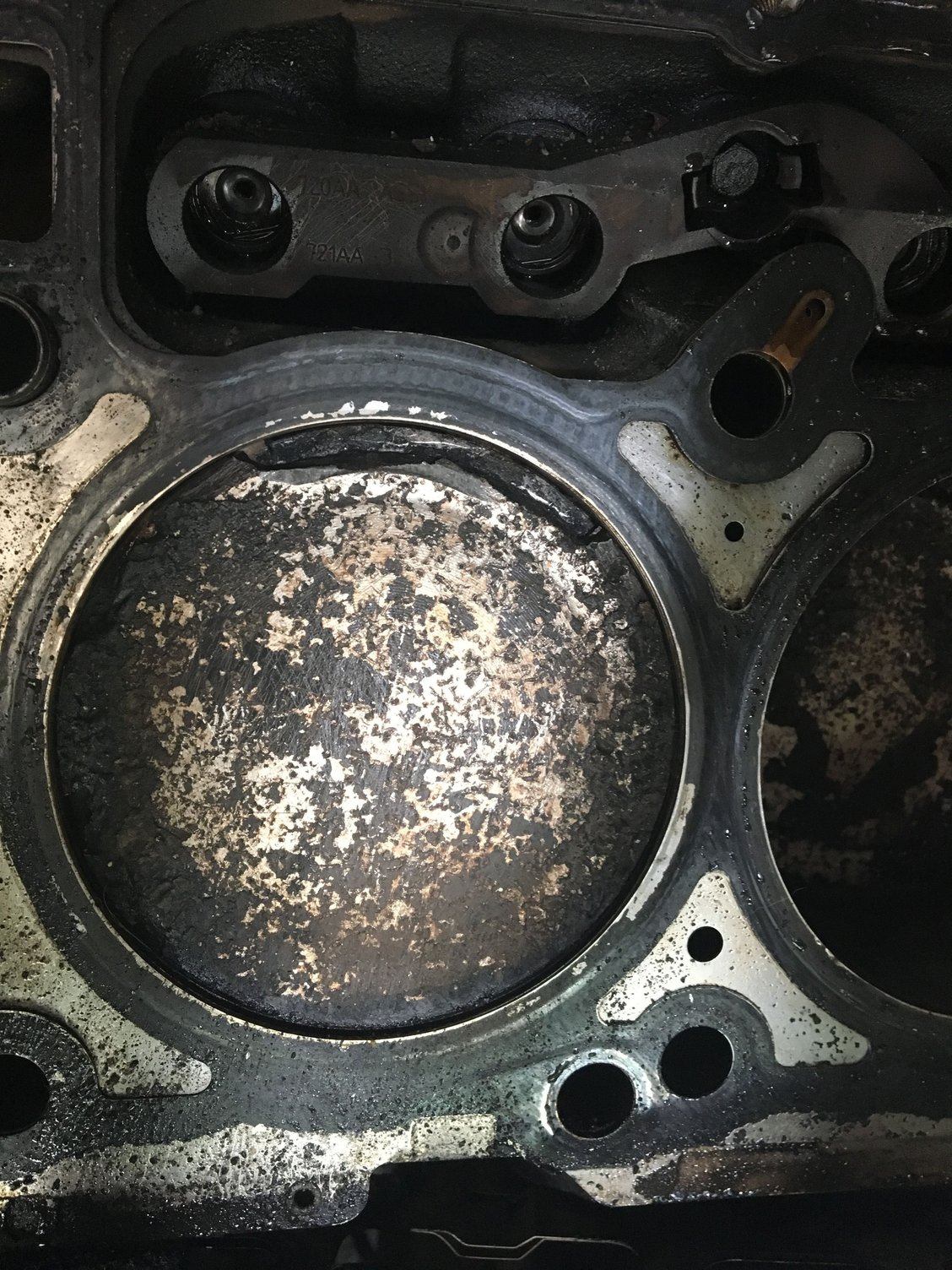

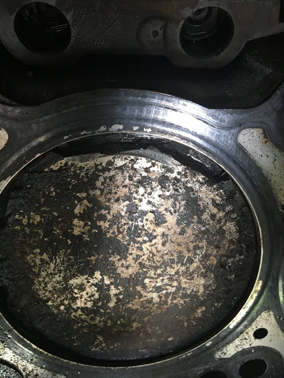

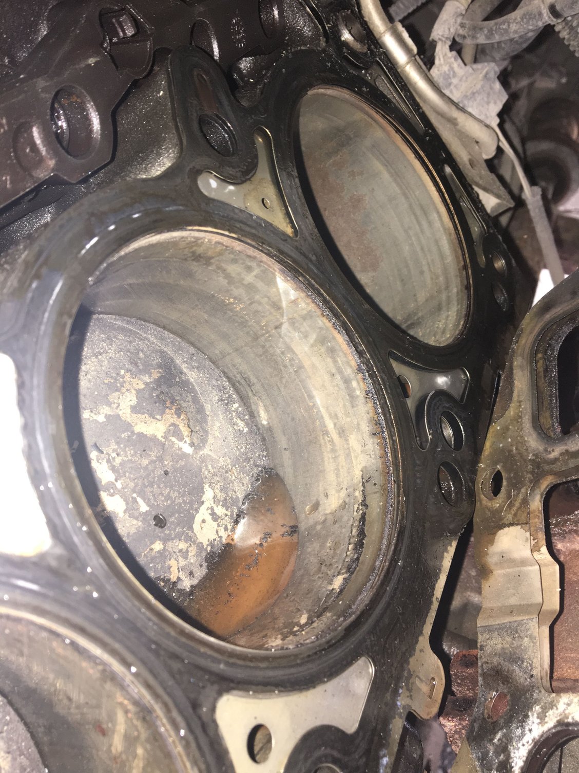

#1 #3 and #5 look the same oh crap is it possible to do pistons without pulling the motor or what next

Wow. No doubt cylinder walls will be damaged. Id be looking for good used engine or rebuilt
